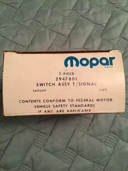

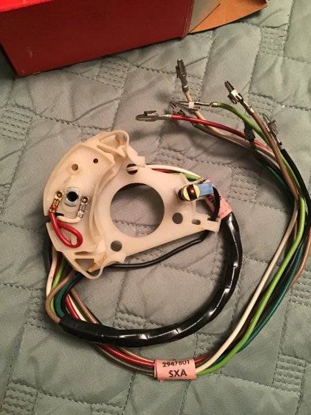

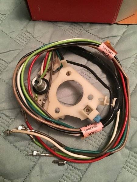

2947801 should work right?
I am looking at one but trying to verify if it fits.

The only difference on the 801 is separate wires vs a ribbon cable on the pt# it superceded.

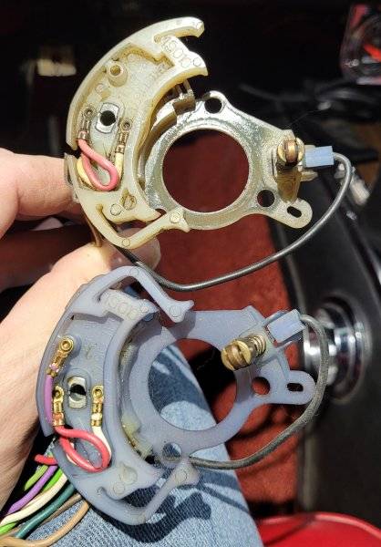

It will work 100%. I used one on my GTX. There are 3 wires you won't use...brown, green and violet. You can cut them off at the switch or leave them, as I did. OEM is soooo much better than aftermarket junk, as you found out.
Comparison with my original...
