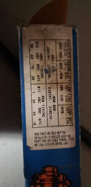

I guess what I want to ask is what would I need to do to get about 400HP if possible based in the limitations. What cam could I use with what I already have that would be street friendly cruiser and still use stock rocker gear, converter? Attached is a photo of the cam box for the cam that is now in the 1970 383 HP block. I know that 383's can be ruined due to an over sized cam which is why I have posted this thread. A photo of the Elgin cam box is show below.

The Elgin cam you have now looks like it would a nice cam for a mild 383. As mentioned above, probably similar performance to stock 383 Magnum. If you are married to the stock torque converter, I would stay with the Elgin. If you want 400 hp you will need more cam . A typical 400 hp 383 is going to want more stall than the stock converter.

That Elgin cam isn't a bad cam. It would run really nice in a 383, just won't get you 400 hp. Would probably be pretty responsive and make decent torque. I thought this 383 I built would make 350 hp and would've been happy with that. I did degree the cam and installed it 2 degrees advanced from comps recommendation since the compression wasn't very high. Looking for a certain hp number can be disappointing at times. And unless you dyno it, you'll never know anyway. I think your heads will be your limitation. Especially if there's no porting done. You'll have to go with more cam than I did, which means less vacuum and more stall. Definitely headers and a good 750 carb.
