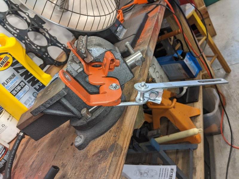

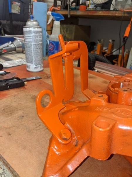

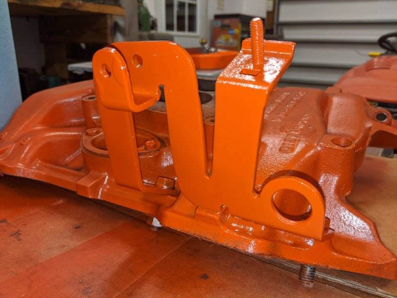

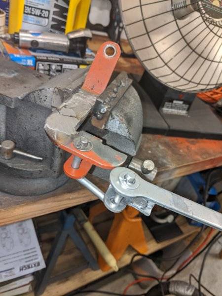

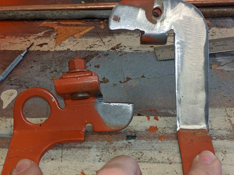

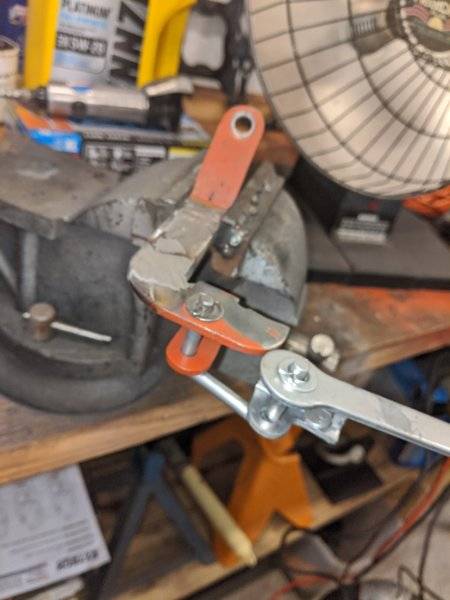

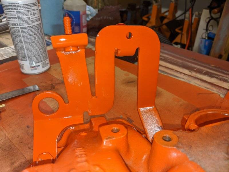

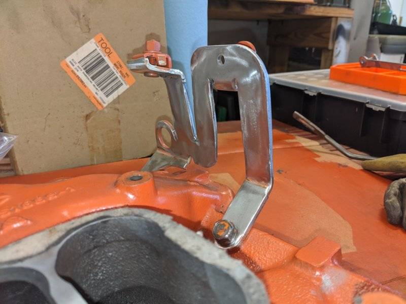

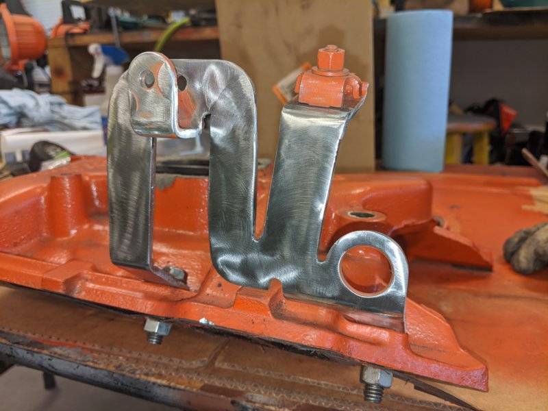

Yes the one I ordered from AR is not for the one piece kickdown. I will send it back. I was going to weld in a small piece of rod to try and fix the geometry. I will also cut the original throttle bracket and weld in a piece of steel to raise that also. I can send pictures when done. Thanks for the replies.
Here's some pictures of my revised tall throttle bracket for the intake (RPM). I didn't like my after market options. Next will be the kickdown rod.

You will also need a different length throttle cable now to reach and adjust correctly
I was hoping the throttle cable will reach. I haven't tried it yet.
Will most likely depend on the linkage hook up provision on your car and what cable you had to begin with. Hope it all works out for you
