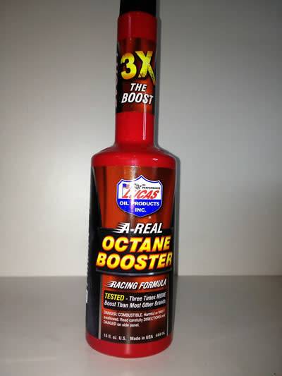

I’ve used this to good effect on my ‘69 11.2:1 CR Shelby GT350:

BUT.....how many bottles of this product did you use to satisfy your "11.2:1 compression ratio" and what was the cost per bottle or what was the dilution ratio of gasoline to octane booster. "Good effect" means?

I fill all my vintage cars with ethanol free 92 from a local station. Keeps my carbs and fuel systems happy. For the Shelby, I then add a bottle of the Lucas octane boost. The car has a 20 gallon tank...and since I don’t run it dry, but down to an UN-scientific 1/4 tank before I refill, it’s essentially getting one bottle/15 gallons. I’ve used other brands of octane boost, but Lucas seems to be consistent. I’ve putted the car around w/o octane boost, but never laid on it w/o octane boost.
I don’t have any ping problems; the car doesn’t diesel following shut-down; the engine has been in the car since ‘03, hyper-pathetic flat top pistons at zero deck; .032” quench; aluminum heads. The cam is not radical...226*@.050, .500 lift. It pulls vacuum for the power brakes. It’s a 4sp.
