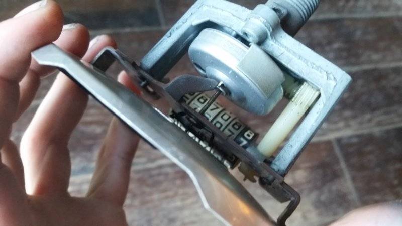

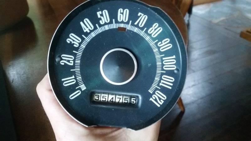

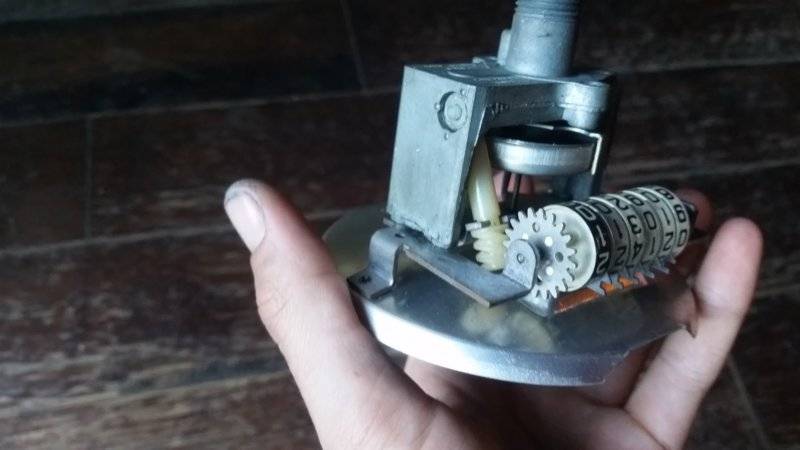

my 64 speedo may function similar to yours. I took some pictures for reference incase it helps!
I had a similar speedo with the same issue. The odometer was sticking between 2 numbers, the plastic gear was still spinning but it would jump to the next tooth and keep going. I think it bent the end tab that holds the numbers too.
Pulled it out, took the numbers off, cleaned it up, no problemo.
I was thinking that the likely problem is the perpendicular smaller gear - I have seen them wear out and skip teeth and i have seen them pop out of their holder
Hey, thanks I really appreciate this. The ppictures are a big plus. I will let you know what I find.
