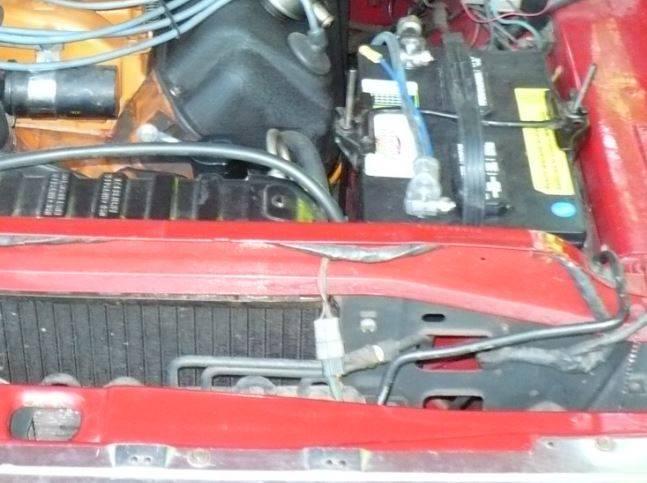

Somebody can send me pics of this transmission cooler hoses??
I have the trans cooler in the front

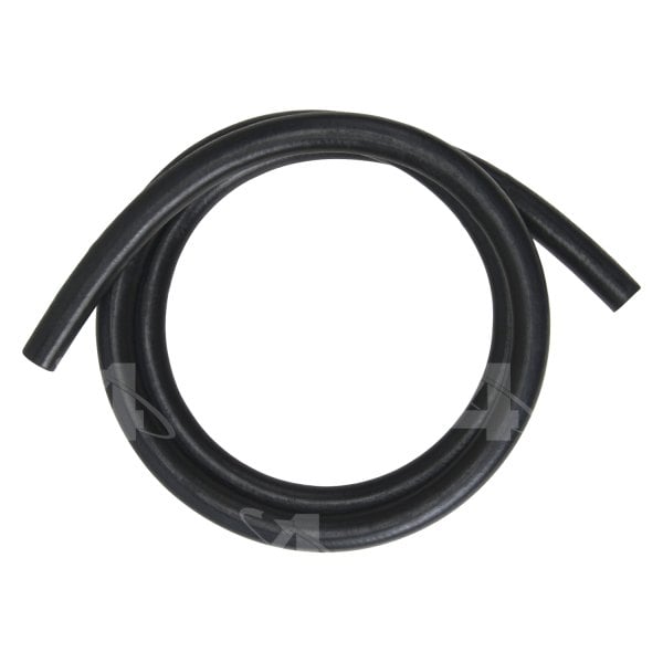

The original lines from the 727 gearbox to the rad were metal tubing. New lines are some fancy hi pressure hose. The hose being a bit fatter, can interfere with the shift mechanism. I bent the shaft, and made a piece to keep the hose away from the shaft. I was told, probably from someone that never owned one, that I needed a dedicated transmission cooler, like a turbo 400. I use the radiator for the cooler, same as stock.

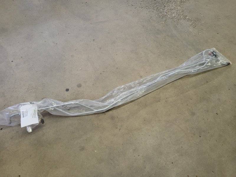

The origional transmission oil cooler (heat exchanger) connections were via hard lines..NOT HOSES.....likely 5/16" aluminum tubing directly from the transmission with female flare nut connections to the oil cooler in the radiators bottom tank. The Factory Service Manual shows these connections and sizes.......

Make sure the hose you buy is rated for trans oil cooling. Fuel line may be the same size but is not rated for the pressure and temperature unless verified by the manufacture of the hose.
BOB RENTON
Exactly. Perhaps sourcing a pair of hard lines from a well-known vendor.
The fancy hose was too much money IMO. If the original is available, I would use it as others have suggested.

Sort of , they were steel not aluminum, but a man of your stature would know what the size was?it's somewhat uncommon
