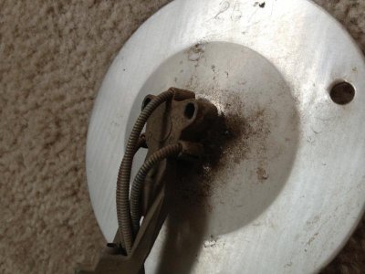

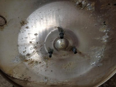

Has anyone ever rebuilt the remote style side view mirror for a 68 charger? Can I reuse or do I need to replace the cable wire that moves the glass.

What's the matter?
Loose?
I've put some washers (3) between the spring points to stiffen them up.
Might have to try several thicknesses and you gotta get just the right diameter and center hole.
Keep test fitting and when it's right it will firm up as soon as the last one gets wedged in.
I need to get it about the get the mirror chromed. After talking with some people I was told uncramp the end by the adjuster in the door with out breaking the crimp section. Lets see how that goes :/

...and as for your original question- yes they are quite the bitch to take apart.
I've not heard of any secrets, and haven't been too successful myself.
Hopefully someone else will chime in.
This is definitely the forum for that!!
I got the wires off the knob good thing I have a nicer extra one, but I was able to get it about nicely. My mirror was non-pitted but the peppering and in need of new mirror glass.
