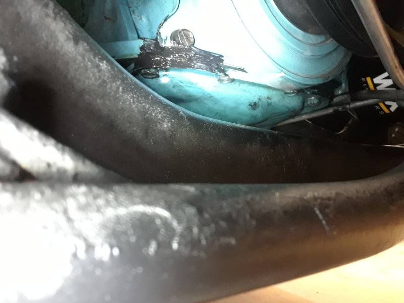

So I told them I am tackling my oil pan leak for the third time this Holiday break. We discussed what I've done to date and the leak that still happens where the timing chain cover meets the oil pan. Currently I have a MOROSO Blue Silicone gasket that works well sealing everywhere except at the timing chain cover.

You are sure it's not leaking on the balancer?

The balancer is not leaking.

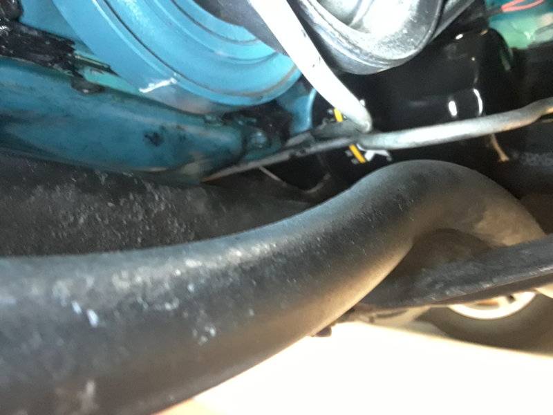

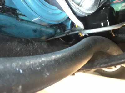

Having said that, I am somewhat confident the stuff works well. Just a 15 minute idle while on jack stands and no leaks, but I'm not calling it fixed until a road test.
Looks messy in the pictures but actually not that bad.

So I ran a neat bead of the stuff on the timing chain cover inside area, on the oil pan gasket surfaces, and really was generous were the leaks/seeps were where the timing cover meets the oil pan.
So far so good!
