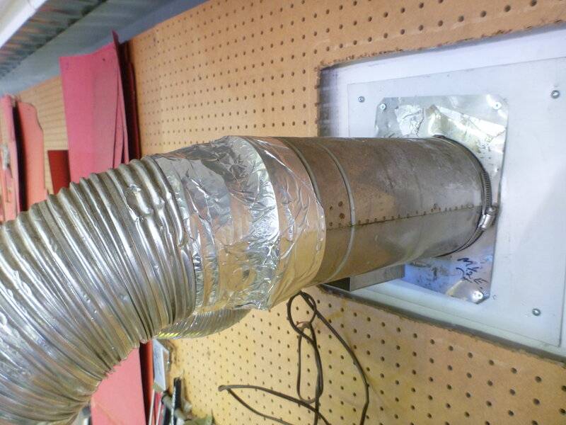

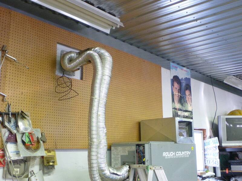

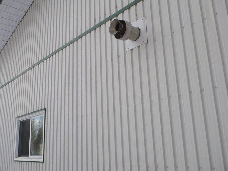

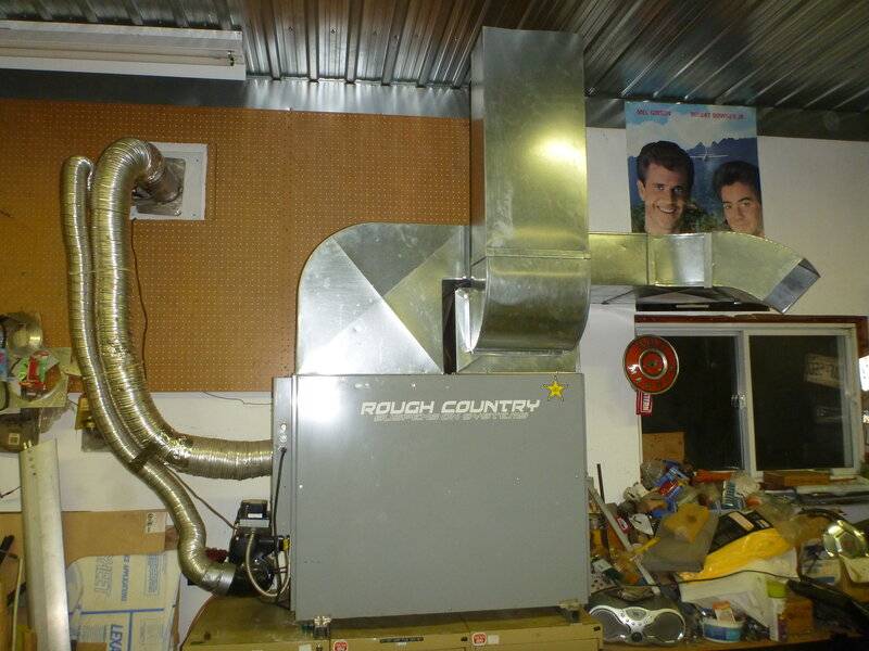

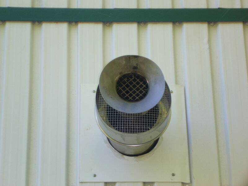

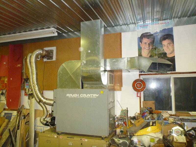

Mine.. Air in and exhaust out through the same wall venter. No chance of sucking in fumes that go boom this way...

I picked this furnace up from another guy that converted to propane. The burner fan/pump comes on, the reed switch detects air flow at the wall venter and then the oil valve opens and the burner lights. The wall venter, the intake air flows around the outside of the exhaust keeping it cool for zero clearance installation. Intake air comes in on the 4" diameter and the exhaust pipe is double layer. it's a 3 or 4" inside that insulated 6" pipe..

I was not aware that aluminum flexiliner vents were allowed on exhaust from oil burners?

Dadsbee, that wall termination is what is called a concentric termination, I was more interested in the other end, where the fresh air is connected to the burner.
