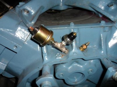

oil pressure sending unit where is i located?

the 440 ci. is now in a 64 sport fury it's a 70 to 73 engine from #'s on the block,heads etc
the oil sending unit should be at the very back of the block right above the bellhousing in the center of the block. there will be two plugs and or else sending units there
