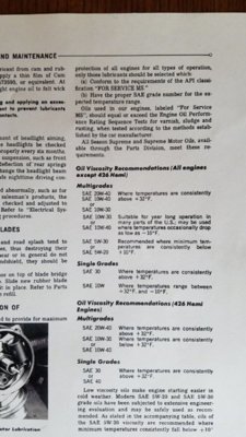

Any suggestions on oil weight for an original 440 six pack 1969 Bee with 50k miles? I live in Iowa but the car never gets started when the weather is below 32 degrees F.
The attached picture from the service manual suggests a 10w40 or 20w40 if it doesn't get started much under 32 degrees F.
I was leaning towards a heavier weight, but I can't really find a 20w40 as it appears everything has went to 20w50.
Interestingly enough, 20w50 is listed as an optional oil for my 1973 400 Charger. Maybe 20w50 wasn't really marketed until between 1969 and 1973?

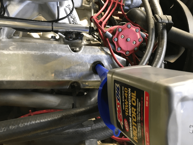

My experience in my 360 with a hydraulic flat tappet cam is this; I was using Valvoline 20w50 high zinc oil becuase it was easily obtained on the shelf at Oreillys. I am in Phoenix which does not have winter, so I thought the 20w50 being a "summer" higher temp grade would be fine. Problem I had with it was very noisy lifters. Talking with a few engine builders I was told to switch to a 10w30 high zinc oil. I first tried used standard grade 10w30 off the shelf oils with a zinc additive. Noisy lifter problem is gone. Now I use this which I order from Summit Racing.
