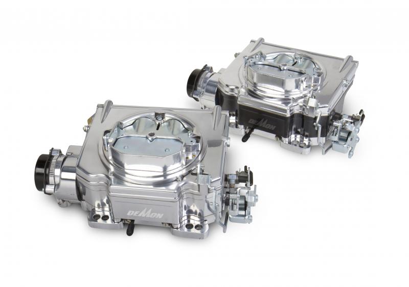

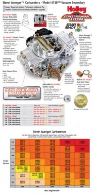

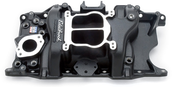

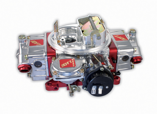

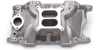

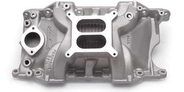

An Edelbrock Performer Intake you can use a spread-bore type carb without an adapter or a 4150 square bore carb with the right gaskets or a mechanical stove type choke too if wanted {or Performer RPM for more power your adding later, square bore/dual plane design}, with a 525cfm - 625cfm Road Demon or Street Demon 625cfm spread-bore style carb {no need for a spead-bore adapter, they will bolt onto a 4150 square bore manifold, I would suggest to stay away from the Edelbrock Perfomer series carbs IMHFO, I'm not a big fan of them at all, some people love & swear by them & I'm not one of those people... A good Holley/Quickfuel670-680cfm Vac. {or Proform}, Vacuum sec. carb with electric choke and for auto-trans for ease & simplicity & a Double Pumper for a manual trans... I'd suggest getting a hooter ignition & coil, along with some ultra-Low Ohm resistance plug-wires, a good gauze type air cleaner element too... By a couple of books on what ever you decide to use, get to know the inner workings of what you have & learn cause & effect of tuning them... I'd run a old rebuilt Carter AFB or AVS or even an old Thermoquad any-day, long before the Edelbrock/Weber Carter clones, they have their place just not in my garage... Not trying to start a "best carburetor debate", that's just my honest opinions, take or leave it...
Ok SO I was Wrong ! There is a Swap meet this Sunday near me. I am going to check it out. How do I identify intakes that would fit my 318?
The most common one is the "Performer 318/360".
I always take pictures of the parts I'm needing to swap meets to make sure all the goes-into's and comes-outta's are in the right place since those tags on items are often wrong. Sometimes a little, sometimes a LOT. :)

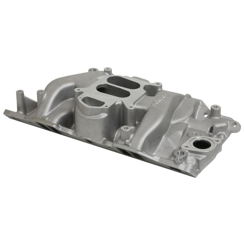

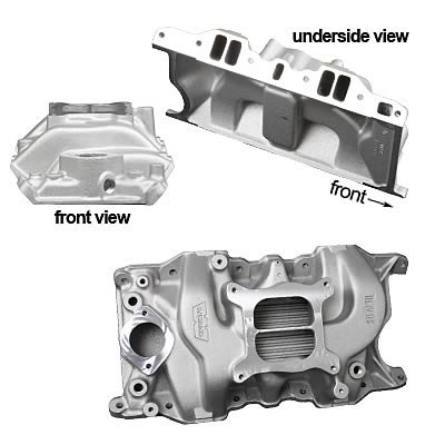

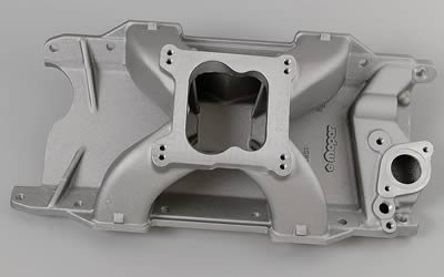

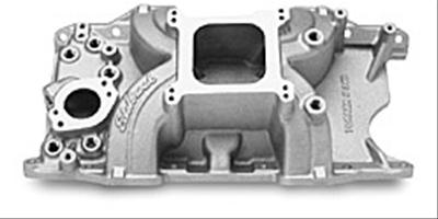

Look at the photos I posted they are for a LA-series 273-318-340-360 SBM Wedge here's a couple more Edelbrock Torquer II, Mopar Performance Dual & Single Plane, Weiand Stealth Dual Plane... copy the photos & take them with you if necessary, or bring a Summit or Jegs catalog or something... IMHFO generally at swap meets, most sellers/people will pretty much honestly tell you what things fit, if your not sure, then find some who does know, before you buy.... the SB Mopar will have a notch/recessed area for where the distributor fits, in the back, for example a SB-Chevy manifold looks similar, but will have a hole where the distr. goes, instead of a notch, like the SB Mopars... Good luck, Happy Hunting
  • Intake 273-318-340-360 LA Mopar M1 single plane dcc-4876334_w $239 Summit Racing.jpg
  • Intake 273-318-340-360 LA Weiand Stealth #wnd-8022_w $226 Summit Racing.jpg
