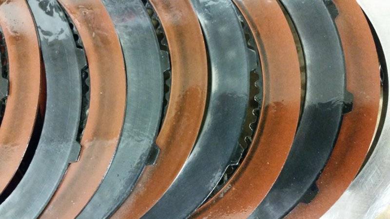

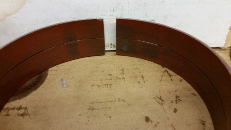

Here's a pic of the frictions and band from my 9.0@3350lb car. Aprox 250 passes when checked using Walmart Dexron. It's apart for inspection now at 350 passes. They look exactly the same.
Doug
Dex can work fine in a drag car especially with alto clutches
If you use it in an on the road vehicle, especially severe service change regularly - or use a better fluid
look for the ALLISON 386 spec if your want to be sure you have the real thing also the "H" version
