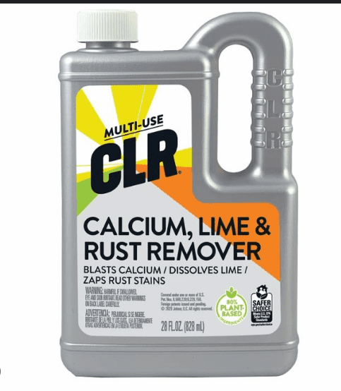

Most use the ultrasonic cleaning. Rodding is a thing of the past for most shops.
Plug off the inlet and outlet and put some of this in it.
Yeah do a serious flush to it, should help
