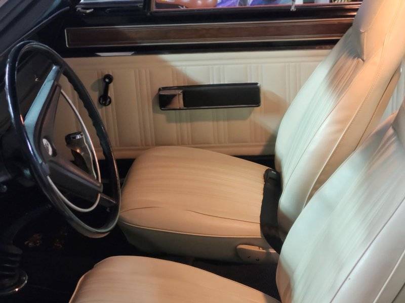

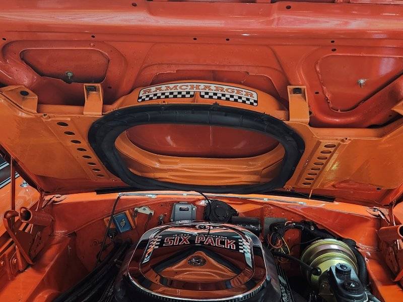

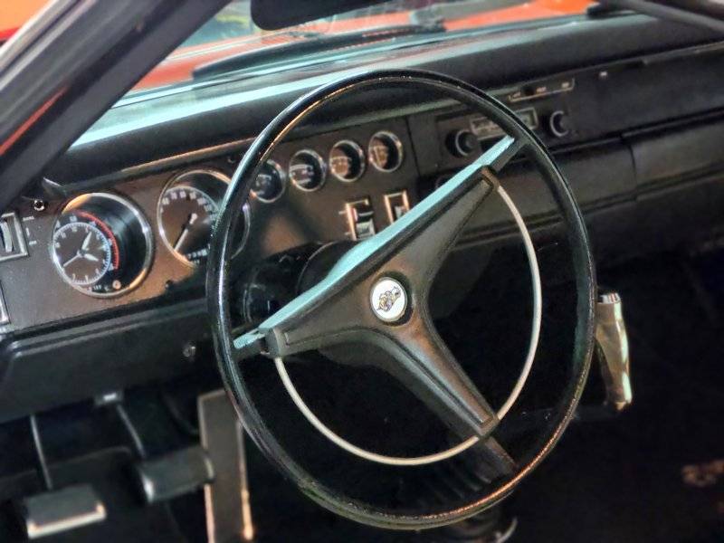

I like a lot about it, but became less enthusiastic when I discovered it isn't a V code. The black dash is a head scratcher though considering it was born a true WM Bee.

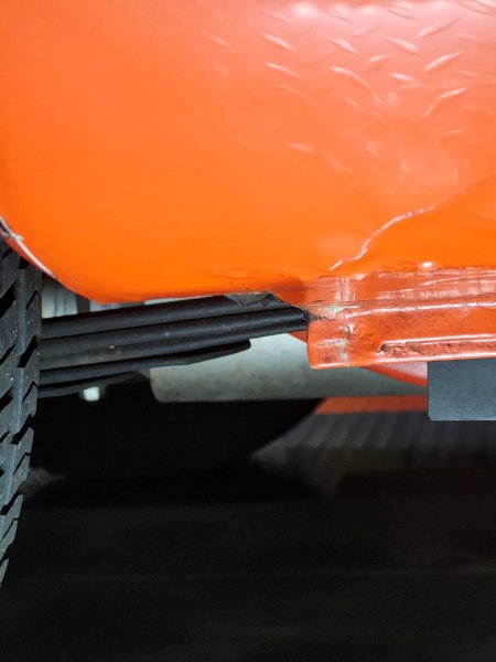

That bondo popping back out would concern me in a big way. Again, dependent on $$$$$

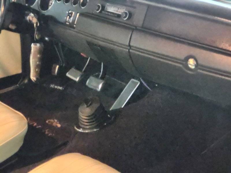

Yes it should have a wood grain dash. Should have white armrests. Sharp looking Bee.Build sheet,fender tag? I pic of the vin will tell you engine
grab a frig magnet to see how much bondo.
wood grain on door is for coronet rt I believe not Bee, top of inside door should be white not black.,converted to electronic dis,why only 2 prong ballast, Spliced wires?
1st pic I dont really see the bumper filler

But it is not. Asking 75k. Therein lies the hesitance. It's got almost everything I want, the motor is pretty impressive, but a lot of it looks to have been done haphazard, the cracked bondo drives me away faster than anything, and at that price it should be beyond immaculate and a numbers matching V code. Add another 3K maybe to get the correct dash panel alone. Also bothers me they hid the appraisal. If it were anywhere near the asking price why do that? Honestly all these cars asking this amount are because of the same 2 1970 Super Bee 383 cars with the fresh rotisserie restoration that one seller keeps relisting on ebay over and over and over making them think that's a real price they sell at. I wish that guy would knock it the f off.

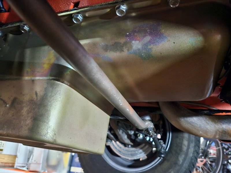

Looks like after market front power disk brakes, wiper motor painted black, no reverse light on the dash are a few other things. 75k to high to me.
For 75K it better not have bondo coming back out.
