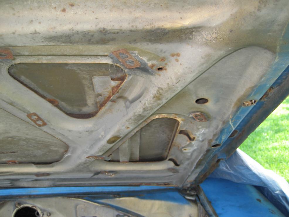

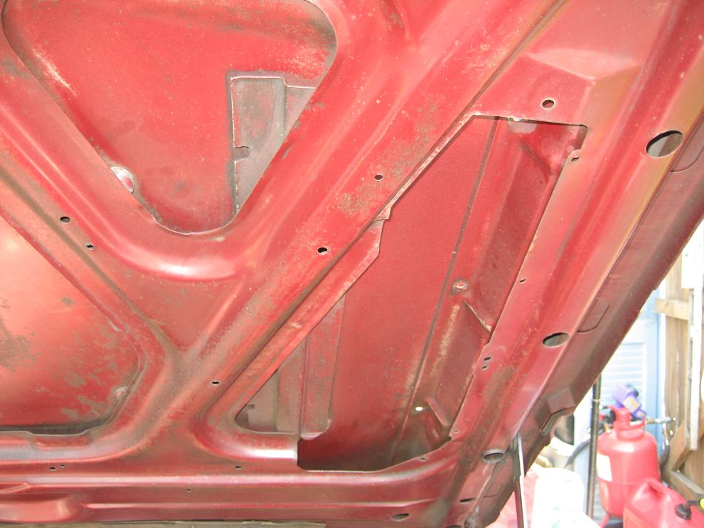

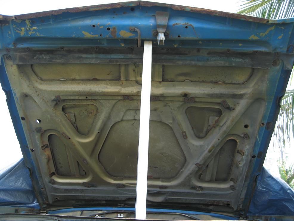

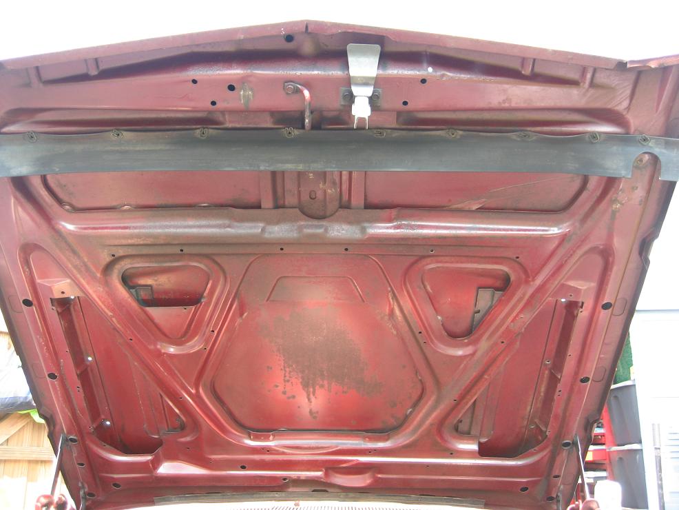

Meep-Meep is on it. 68 and 69 hoods were different as stated. You CAN bolt 68 inserts in a 69 hood, but CANNOT bolt 69 inserts in a 68 hood as they are solid under the inserts, see last pic. There was also two 68 hoods. The skins were the same but the frame work was different. The red hood is a late 68, gold and bule is early style. Cut off for the early hood seems to be between late Feb. and mid Mar.

Look at the pictures I posed above. It shows early and late 68 hoods. The only difference in a late 68 and 69 hood is the cut outs under the inserts. Late 68 hood had the same understructure as a 69, they must have been preparing for the air grabber hoods for 69.
