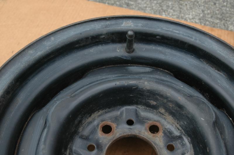

How can the 14" x 6.5" optional Max Wedge wheels be identified? Are there any stampings that are unique to them? Were they available on other cars?
Should be a part number on them......and they may have been used on other cars but not many others if any. Not sure if station wagons came with a larger wheel during that time or not but I know in later years, they usually came with larger wheels. Keep in mind that there were not that many tires to choose from and even in 1970, G60 was considered a fairly large tire.
MoPar wheels did not have P/N stamped in until 1970. But had date codes and wheel vender stamped in through out all muscle car years.
The 'optional' ramcharger wheel 6.5x14 naturally looks like all the others from the face. "Most" 62-67 wheels have size stamped by valvestem, or on lughole web area. The part numbe was Not stamped on outside or inside of wheel. Some Chrysler wagons came with the 6.5 wheels. Enclosed is a photo of one.
