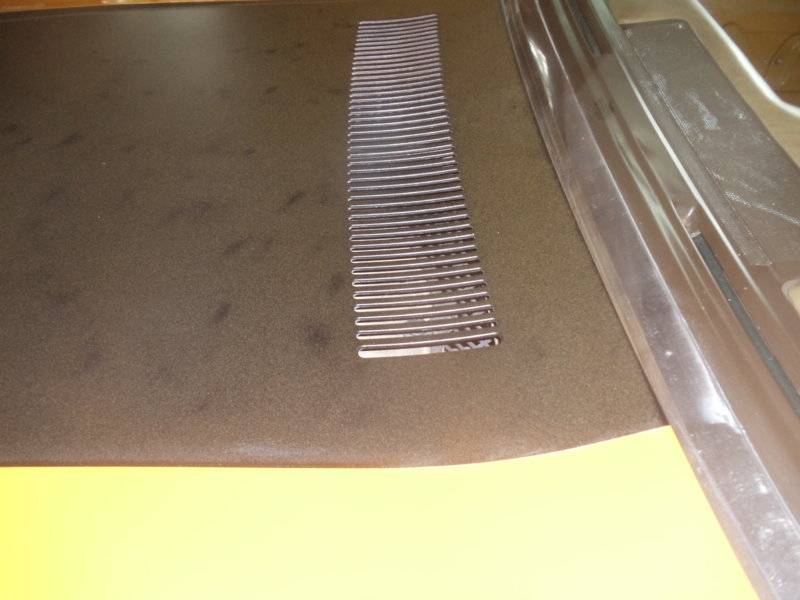

Did the factory paint the air grabber hood all the way past the slotted air vents in the hood (as in the foto below) or was there a small strip of the hood painted body color? Thank you.
I think I saw a post about the same question within the last couple months on this site. I vaguely recalled it had to do with some type of hood stripe option??? At least in '70, the air grabber section could just come body color. Both standard & air grabber hoods had option stripes. I think the '71-'72 is a similar situation, but there's two hood stipe options??? Somebody here knows more than I do for sure.
They've come both ways. Some only the air grabber, some with the rear of the hood.
i believe there was a discussion about this on one of the mopar sites on FB not too long ago.
Thanks for the links, reminds me of a a song by Journey "Anyway You Want It." Or maybe Burger King's "Have It Your Way."
71 had it to the cowl if there was a V21 code...
72 just the AG, unless V21 had stripes bordering the AG like mine in my avatar.
Either way looks bitchin'.

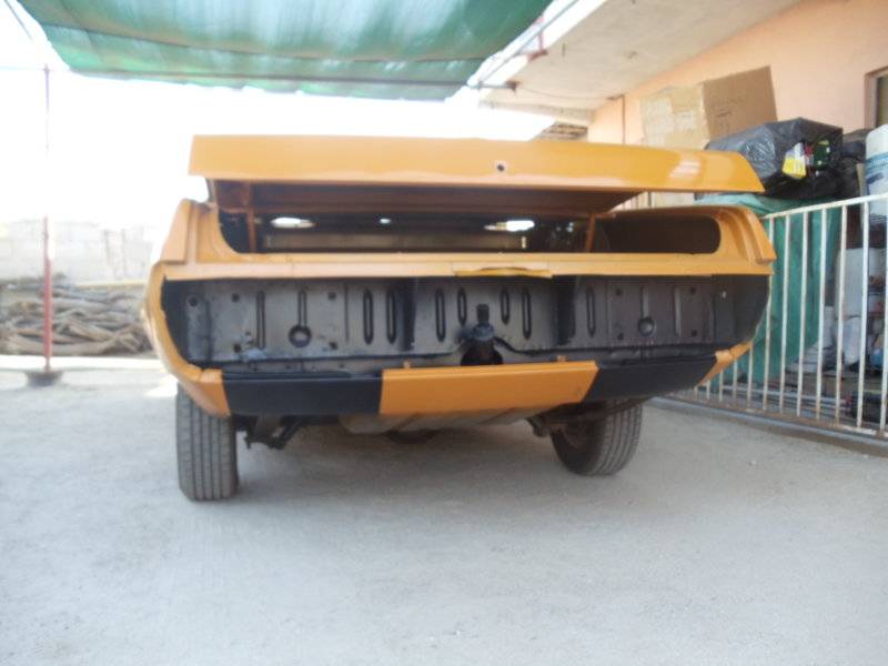

Parents had a new (special order) '71 Bahama Yellow N96. Funny thing is, in the two years family had the car, don't have even one foto.
And the bumper tail light tape treatment was part of which option code again?
Anyone just paint the rear valance stripes like I did?
I have the rear bumper tape treatment decal still in the box.
A87
