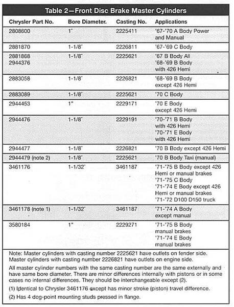

Thats wrong master cyl for disc brakes
But overall a good buy for that money
That looks like the master cylinder on my '67 R/T with disc brakes. '68 and up had bail wire type covers.
I'll respectively disagree.
1967 and up disc brake cars used the bail wire master as you call it
More importantly, disc m/c's have a larger reservoir for the fronts.
Drum are the same fr/back
