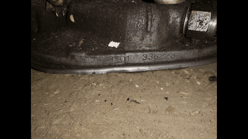

How about this whats the trans ?
H28 9 should be 28 Aug 1969, unclear on the 01, and the 336228 might be the last 6 (sequence number) of the vin. I would like to think the 01 meant 1970, but the 1 needs to be a letter (assy plant). If your vin ends in 336228, I would say that the trans is the original.
