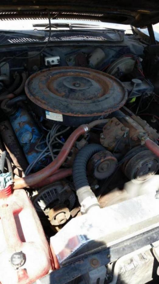

Recently purchased a non running 1972 Sebring Plus. 400/727/8.75 rear and 3.23. Has 1971 Roadrunner front clip and hood. Car sat for at least 15 years. After cleaning carb, putting aluminum radiator and fresh oil and filter change, hooked gas can to fuel pump, she woke up from her long slumber. Had a miss and a knock coming from the intake, like someone was under the intake with a hammer swinging away sporadically. After pulling valve covers, #1 intake pushrod was mangled. During replacement I realized the intake valve was stuck open! That explains the knock! I pulled the #1 plug, used a screw driver and brass hammer to work the valve loose, after that, the old big block ran like a champ.

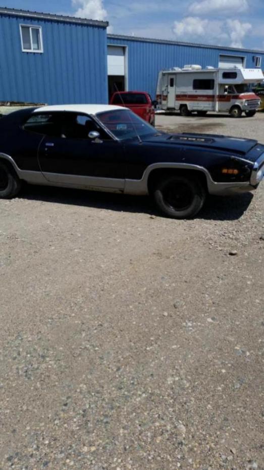

Here are some more pics

Welcome to Mopar University. Glad to have you and thx for the pic of your ride. Pls keep us posted on questions and/or what you decide to do with her.

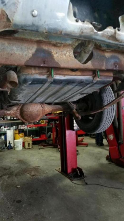

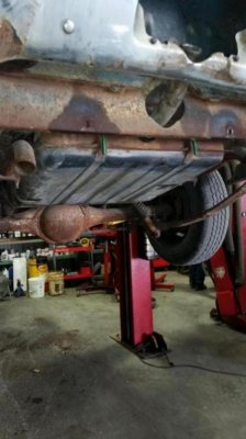

Just got my gas tank back last week, trying to get the old gal road worthy again to make one of the cruise nights. Also trying to straighten the front and rear valances, the right front fender, and rear bumper. Did fix a Trans leak and replaced the Trans mount. More updates with pic to follow.

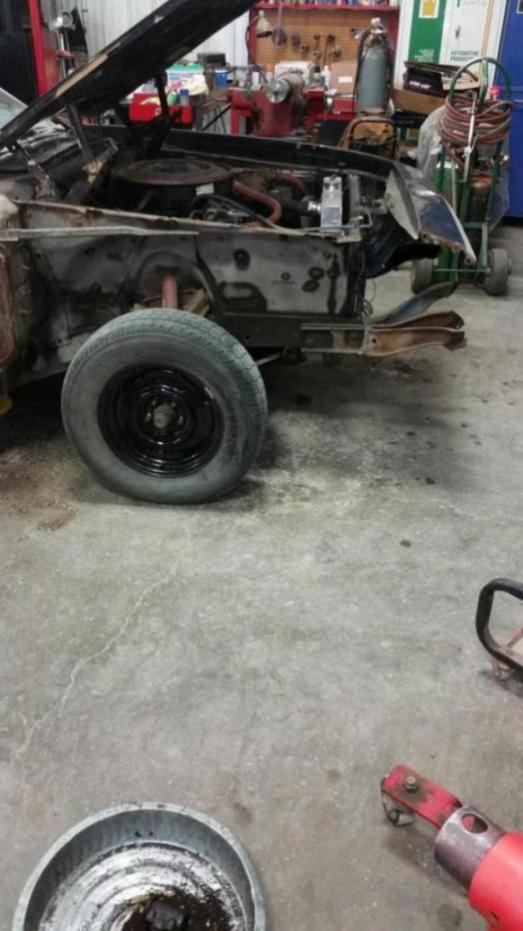

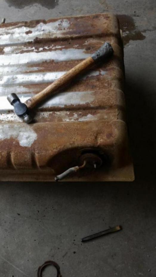

Thanks again for the welcome in, just installed the fuel tank with a refurbished sending unit. Plus I removed the front fender to check door fitment issues. Now it opens! Plus I found some more rust, surprise! Lol
