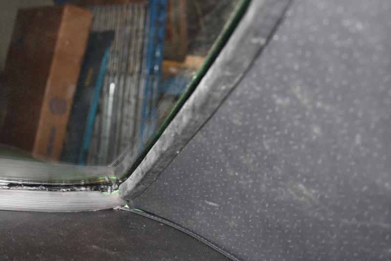

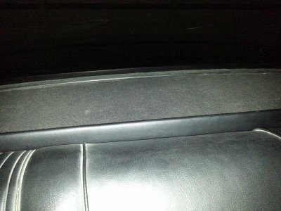

I have a 1969 coronet R/T and i am having trouble figuring out how the rear interior window trim is suppose to mount on the package tray. I understand some people have told me staples and some people told me that it slides into the groove on the trim. Maybe i have the wrong trim? The piece that I have is the exact same shape of the two upper pieces. This puts the groove facing the opposite way(towards the window) for the trim is to look right. Can someone send me a picture of theirs possibly.
Yes, you have the wrong piece for the bottom. The one shown is for up and around the glass. The one that slides on the package tray is completely different. Best picture I have is posted below.
D

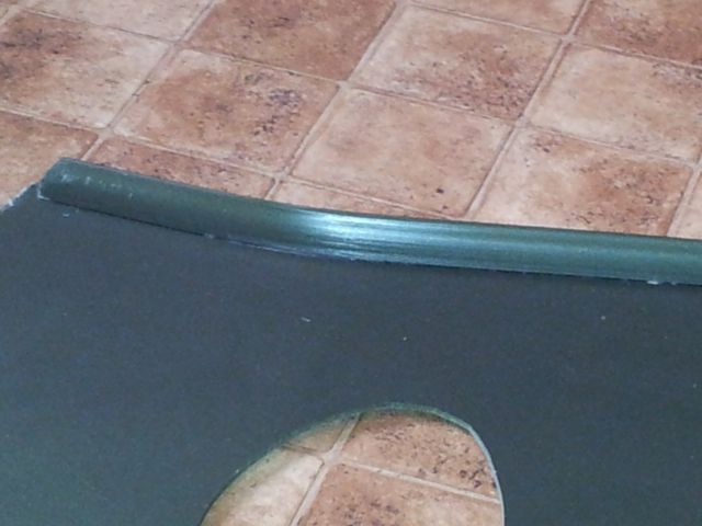

I bought this as a reproduction kit for my car. It is shaped for the package tray but i guess they are sending out wrong peices.

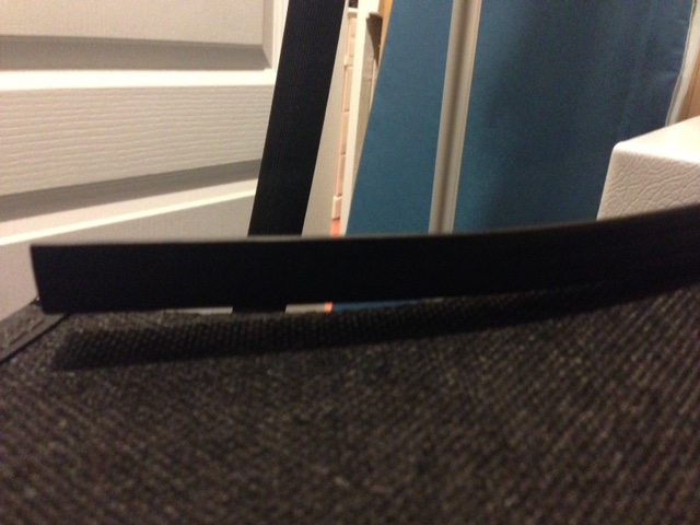

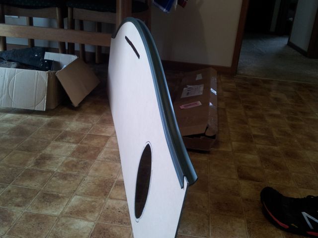

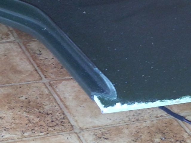

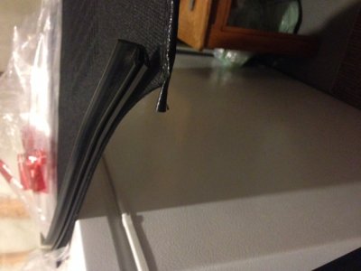

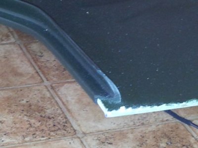

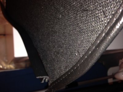

Here's some pics from my 70 gtx. It's not in the car yet so if you need other pics let me know.
