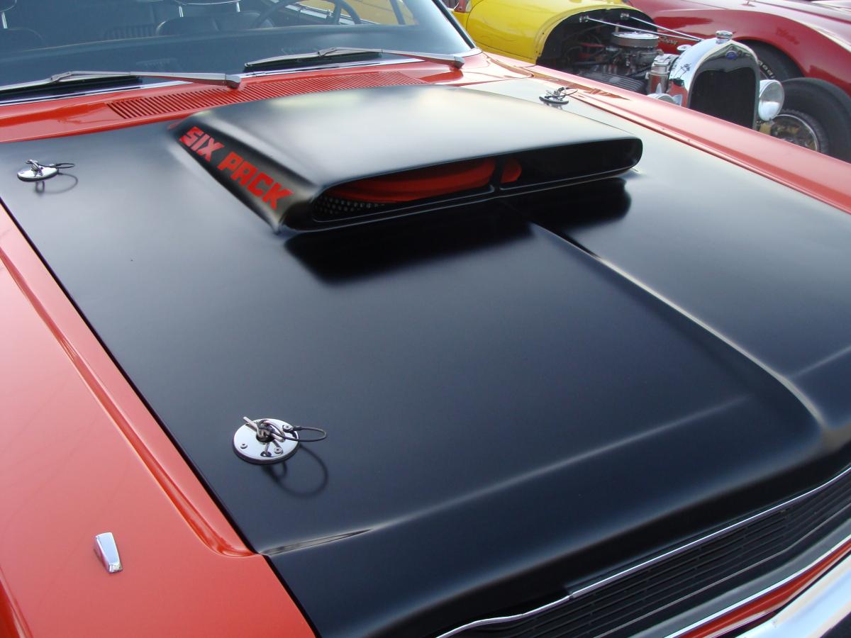

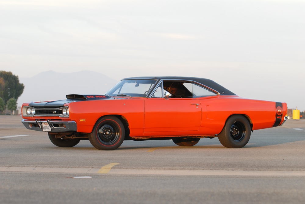

Someone here will chime in who really has experience with it. I have an original A12 Bee and it has a semi flat black hood. It has a lot of texture to it and there is some debate about whether or not its organisol. Totally Auto sells the correct single stage paint to paint your hood with. You can get it in a spray can or in a pint for a spray gun. Thats what my hood has on it now after I had it repaired. Of course it got a new sticker to go with it. I dont think you can get the right texture or orange peel with a BC/CC paint.
