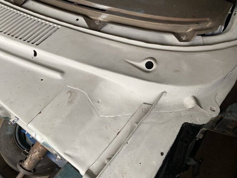

Wondering if any NJ area comrades have a personal Paintless dent repair kit they would be willing to loan.
I have a roller that I can’t bring anywhere but would like to try to work on a problem I created. When welding my upper cowl back on, I applied too much heat and warped it, so it has a low spot. If I can avoid the stud welder/puller, I would prefer that.

I don’t have access to the bottom side, as it’s all welded in place - so I can’t use hammer/dolly.
Heat it with a torch and then throw a soaking wet rag on it to shrink may work. Don't see a suction dent repair fixing a heat warp.
I’m trying not to ruin the coating on the underside of the cowl ( or worse set it on fire, lol). That’s why I thought of the PDR.
This is about the best angle I can get on a picture.
Where's the dent? If it is a dent in from the outside just fill it. If it is a convex dent (from the inside out) tap it in and fill it. As long as the metal isn't elastic and oil can's you should be fine.

It’s a low spot from about 3” to left of the wiper pivot hole to about 2” to the right of it. If I fill it, I’m going to bury part of the pivot hole and that entire feature around it. I either need to pull the area up or leave it as is.

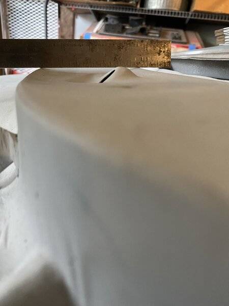

Here’s a better pic. That’s about 3/16” gap at it’s lowest point.

Pull it with a stud gun and simply touch it up with epoxy and a small roller using a mirror(s) to see it. That's far more than was ever coated from the factory and nobody will ever see it anyway.
You could also fabricate a J hook and pull up through the wiper pivot.

That may be worth a try to see if it pops back. Thanks
