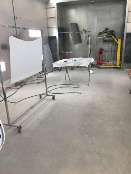

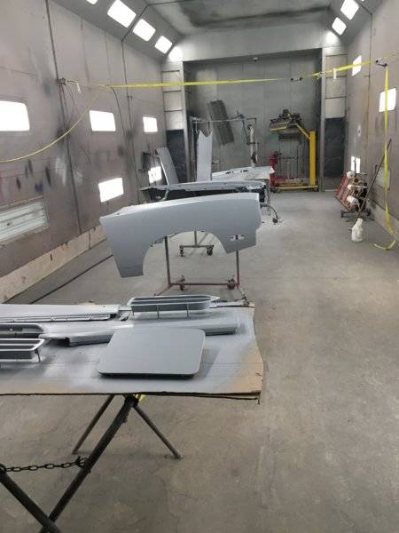

Hey everybody,
My 70 Roadrunner is in the body shop getting ready for final prime. Have some pink questions for y’all, I am not doing a concourse restoration since my car does not have its original drivetrain, but would like to keep it looking semi original paint wise. So the questions I have are.
1. What color should the car be behind the grill on A vitamin C car does it all go body color? Or is there some areas that receive black paint ?
0CC7C10F-8192-4915-89A2-D3D46CA4E226.jpeg 049B2010-A58D-4A2D-B9A7-C6968F1D0980.jpeg
Yes behind grill is semi flat black. They were in a pit when the black was applied. Rad. support & fender head light bucket area was painted black

Hey everybody,
View attachment 554916 View attachment 554917
There are a couple of pictures here that may help. The flat black behind the grill was sprayed after body color and was not done very neatly.
