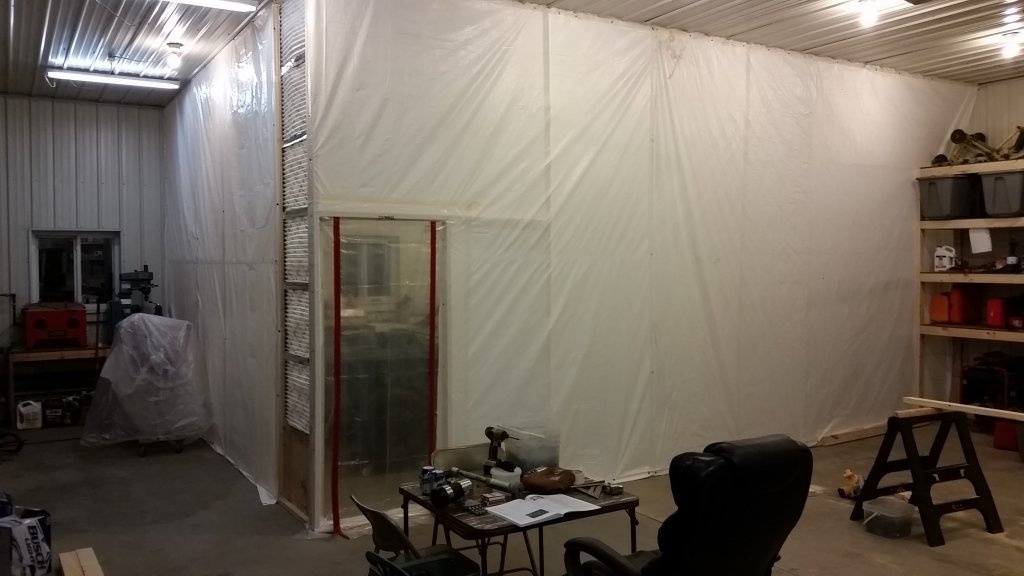

Are you painting outside or making a booth? I made my both out of some 2x4s and white tarps. I have an exhaust fan in the shop and used furnace filters for intakes. The door is a remodeling doorway cover. Works pretty darn good. What kind of paint are you using? Solid colors are fairly easy. Metallics are more fun. Practice on your doors or trunk lid. Make sure if you paint metallic to take the panel out in the sun after it is done! It took me a couple of practice panels to figure out how to drop coat the metallic correctly.
My suggestions are, make a booth out of plastic, wet the floor, prevent any breeze, wash it very well followed by a wipe down with final wash, use at least a moisture filter on the gun, always lay your first coat light to create a tacky surface and put plenty of clear on for wet sanding. I've had really good luck with the plastic makeshift booths and even had some that needed no sanding or buffing when finished. When laying the base keep in mind that it dries super quick, take advantage of this to sand out any blemishes that you encounter (dirt in the base likely results in sanding threw the clear to fix).

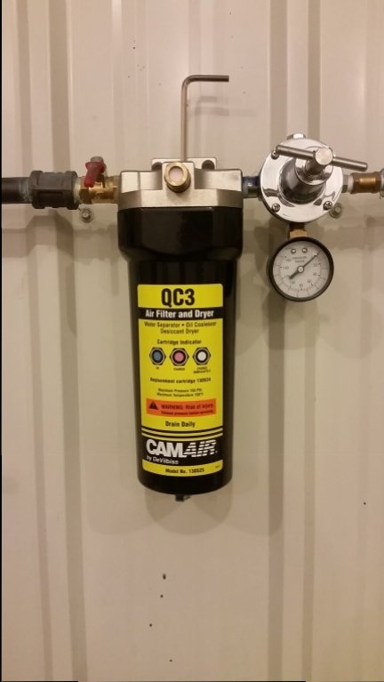

One more very good suggestion. Make sure you have good clean dry air! I use a water trap shortly after the compressor and this filter at the air hose. There is 50ft of pipe between the compressor and the filter. Gives the air a chance to cool. My local restoration guy told me there is 2 things that will ruin your day painting. Water in the air and a moth.

IM gona make a booth in my garage being a general contractor the set up is kinda easy for me, ill do this when my business is slow over winter and then the humidity wont be a issue , its a white car none metallic ,and have a good system for water in the line im kinda a over kill guy when it comes to things like that, I live in camp hill area
