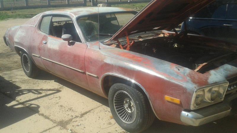

Ok I'd like some input from ppl on fbbo when I paint my car should I put the moldings that are on the doors or should I leave them off the same with the wheel wells

Picture ?
That way I can see.

Send us a pic so we can see.
Here is kennic70's car, more in his gallery.
I am assuming you are asking about leaving them off permanently??????
I say lose the side moldings unless you not going to put the vinyl roof back on? If not I say it would look cleaner without the side trim. If the wheel house molding are in good shape and no splits or breaks, you can restore those and reinstall.

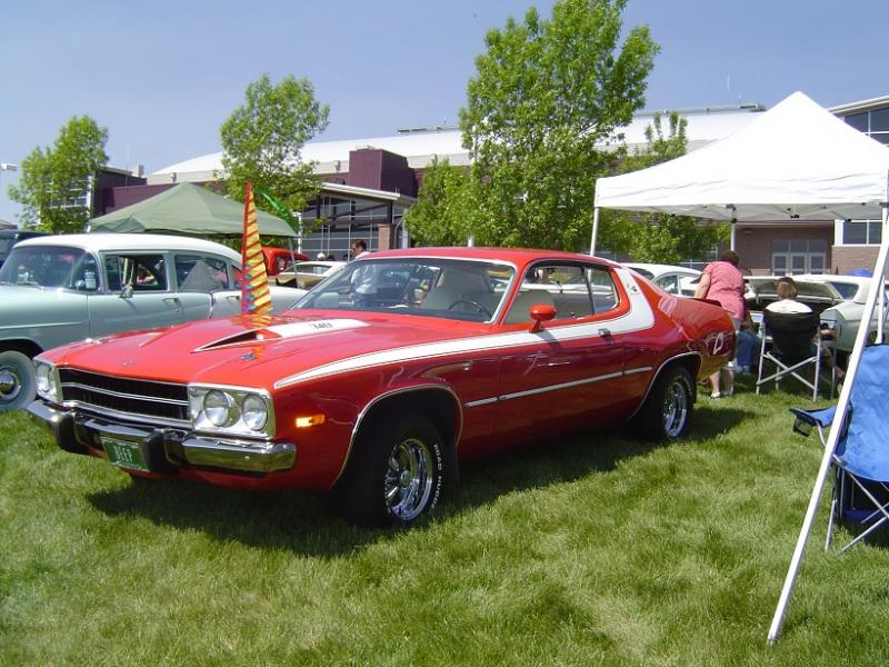

Here is a repainted car with the same moldings you have. Non-vinyl top car.
That's what I was thinking but just wanted to get others thoughts about it by the way what color red is yours

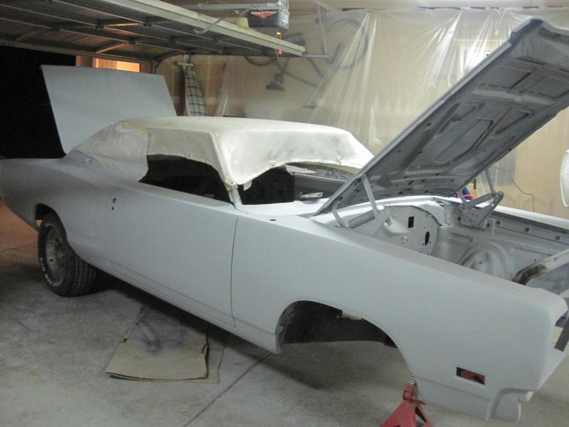

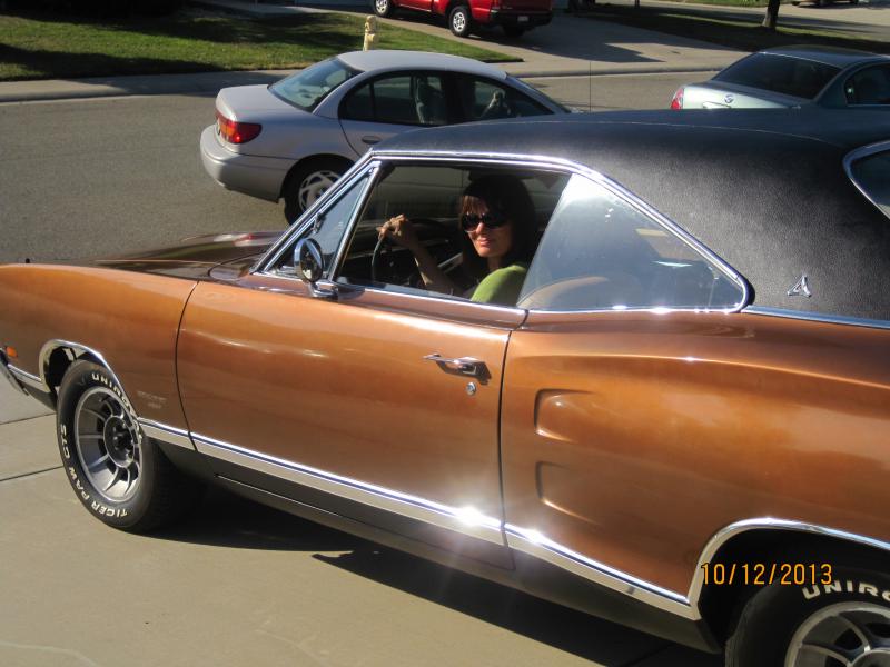

Before:
After:
But it was a lot of work, had to weld up the holes and blend it in. But the Coronet 500 molding was much more prominent than on your car.
