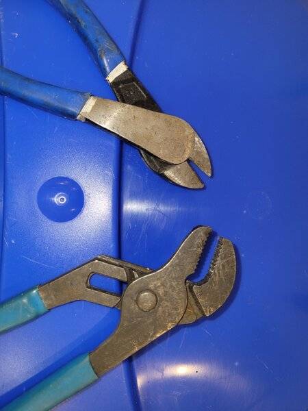

I used to take side cutter pliers (dykes) and lightly grip the cable, between the cable end and the spring, work it in to grip the cable only.
The take channel locks and grip the solid crimp end of the cable.
Pivot and leverage the channel locks and slide the spring back with the side cutters loosely. When you grip the cable with the side cutters, it will hold the spring back under tension.
Once that's done, you can easily install the lever, the cable will be flexible enough to work it in.
You'll need about an inch max.
It sounds more difficult than it is.
