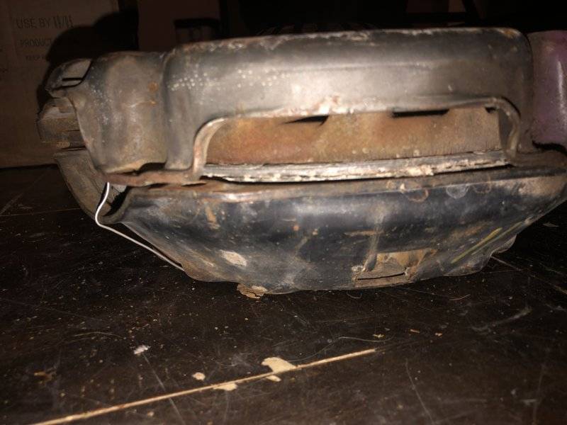

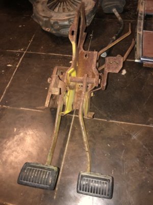

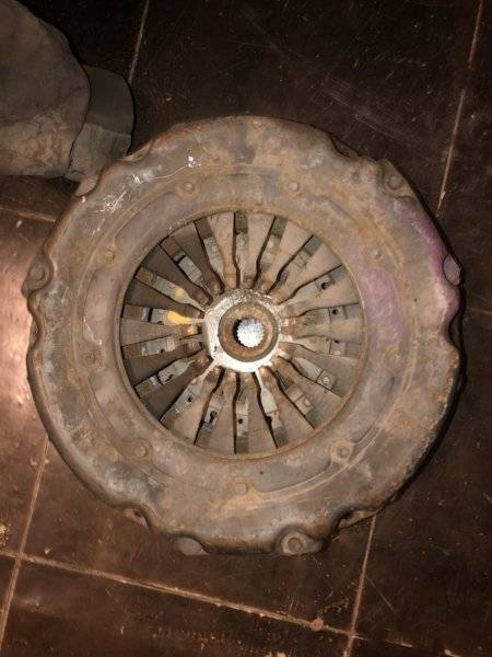

Hey fellow mopar brothers few questions here meet a guy who had BUNCH of A,B,E body parts made a deal with him for a clutch/brake pedal assembly
Center console piece
Shifter arm with knob
Clutch assembly
How do tell if I got the correct parts I have a ‘66 charger I’m doing a half *** ratty build will these work for my car just based on the center console piece i assume they are correct

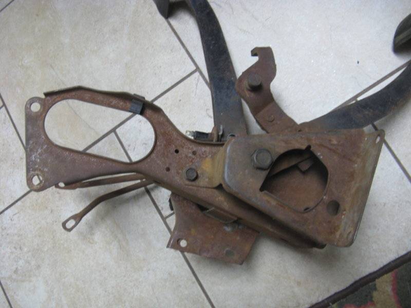

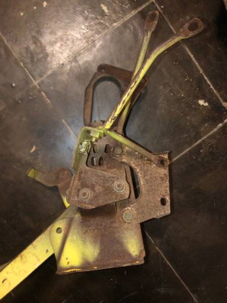

The pedals are correct for your 66

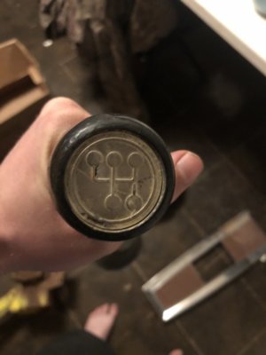

The shifter handle is not. It's a truck/ van 833OD mid-70's and up.

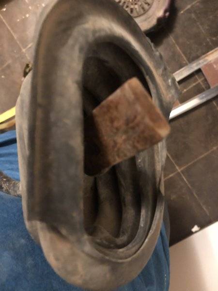

The console plate looks 68-70. Might work.

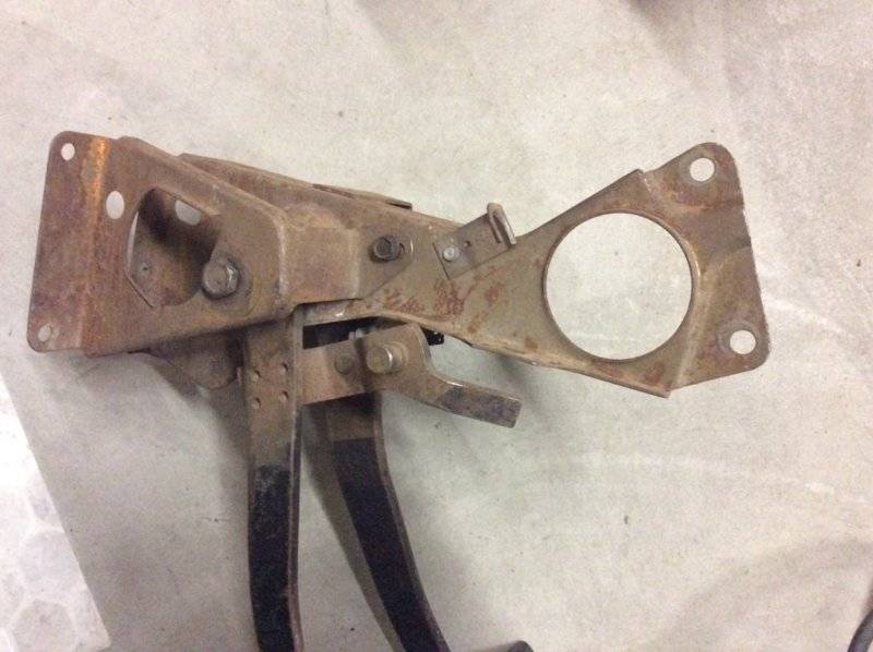

The pedals appear to be 68-70 B-body as the 66-7 b-body has the small hole and 68-70 have the oblong hole....This is a pic of 66-7 pedals..
68-70 Pedals
The console plate is 69-70 judging by the wood grain as 68 is chrome ribbed...But it will physically the 4 speed console...
