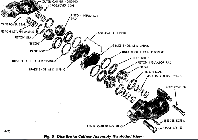

Weren't disc's an option, if they're 4 piston calipers with a single master cylinder it could be factory. Pictures would be nice. If that master cylinder is a disc brake single master it is unobtainum. Don't throw it out if it's bad, if you convert to a dual master. You might be able to sell it for a good price if even if it's bad.
If you have factory disc's they are crazy $$$ to work on

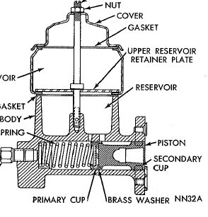

. Here are pictures. Note the master is taller than non-disc cars. 2nd picture is a disc master, 3rd picture is a drum brake master. Disc brake master looks like a reservoir on top of a reservoir?

If it is tall like the second picture it's a factory disc master. You can switch to a 67 disc drum master but you need a junction block to separate front and back brakes and a proportion valve to rear brakes, this is a common change. Not to be Mr. Downer those 4 piston calipers cost a lot to rebuild. If you rebuild them I'd spend the money to have them sleeved. Glad your not tossing parts, you never know. Rear drums maybe 10"x2" but not sure. Had a 69 with disc in front had 10"x2" rears.

No clue. Was there suppose to be a picture? Which does it look like, my picture 2 or 3?
