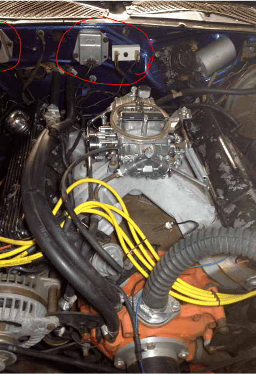

This is my first classic car (carburetor) and first mopar and I have a couple questions regarding items on the firewall. Car is a 1973 Charger SE with a 1969 440 with edelbrock intake and quick fuel carb. Can someone identify what they are for me? Are there any good service manuals (Haynes style) that I should can pick up for this car or the 440?
The item on the center/left is a voltage regulator. On the right is a ballast resistor. The voltage regulator tends to hold up well, but that ballast resister is a part that can fail at any time, so stop by an auto parts store and buy a couple and keep them in the glove box. If your engine dies, and will start when you turn the key but dies as soon as you release the key... that ballast resister is the problem. :)
The item on the far left is the control module for the electronic ignition, which is another item that's good to have a spare for.

Is interesting how lot of ppl says about ballast failures. I never have had any ballast failure in 20 years. Truth is I have changed it once just for upgrades.
My uncle's 73 Dart is still working with factory ECU and Ballast being still now a daily driven car. That is actually an exception LOL.
consider yourself blessed!
My uncle really. As posted before, even the ballast never has being a problem for me, the ECU was allmost a war LOL.
Need to note what I think becomes a problem on ECUs is the lack of power on factory alts! He changed to an AC Delco LOOOOOONG TIME AGO, which are more efficient at iddle, giving a more stable power source

I too have been fortunate to not have a ballast failure but the relative cheap cost and small part size. I keep one around just in case. I also, carry a set of fuses and a puller...
The ballast on my first Roadrunner, a 73 I bought in 1980, failed shortly after I bought it. Never had another one fail until just a couple of months ago. I had 37 years to learn to keep a spare and didn't have one when the time came. Glad I broke down just a short walk from an Autozone. :) Notthing worse than paying a $120 tow fee because of an $8 part.
