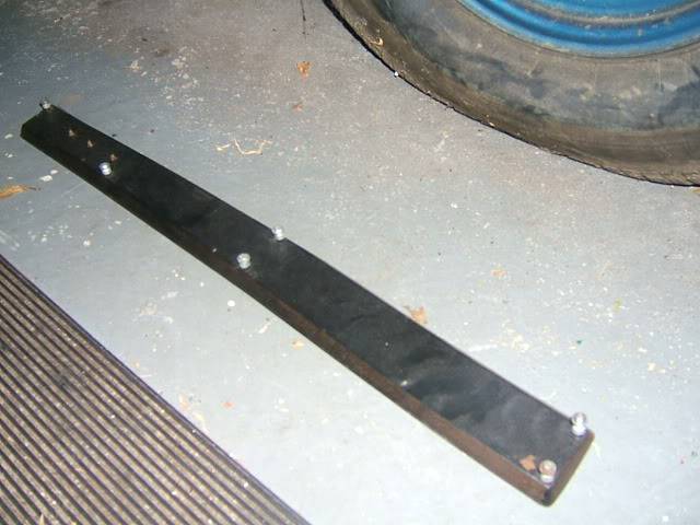

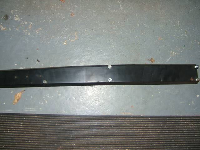

after i dug it out for pics

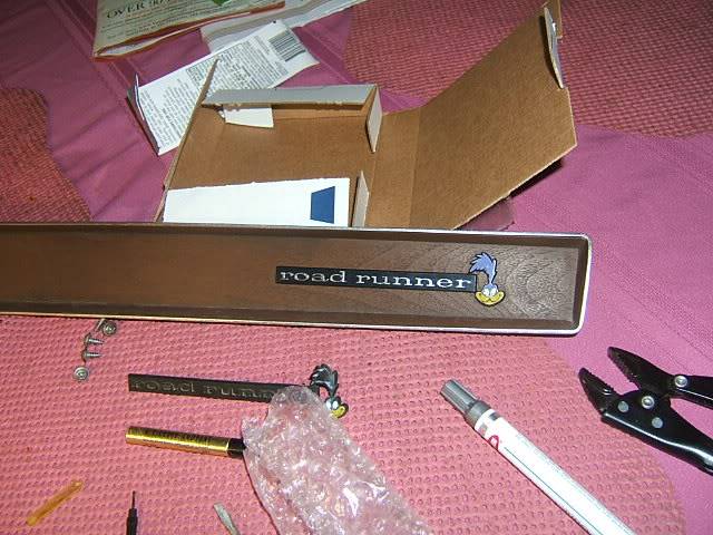

i decided to spiff it up a little
with a nos emblem and doing the outline
the emblem retainers are a pita
it came out pretty nice i think..
