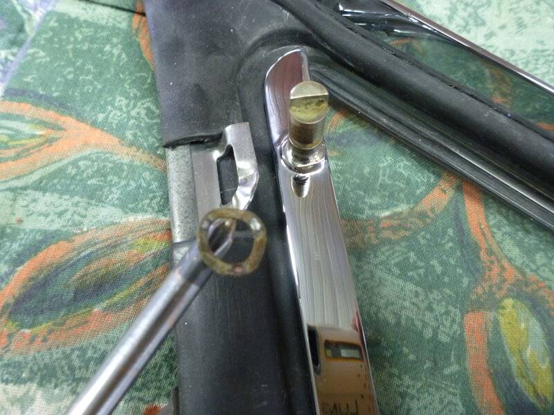

On my car, the passenger side vent window handle has been pulled off of the stud on the inside of the vent window frame. It appears that the handle should have a small set screw to keep it attached. Anyone have a picture of what that set screw looks like and any idea where I could get one? I have been unable to find a new or replacement handle. Thanks.
Have bought set screws at my local hardware store. Take your driver's side handle with set screw in it and a wrench to the store.

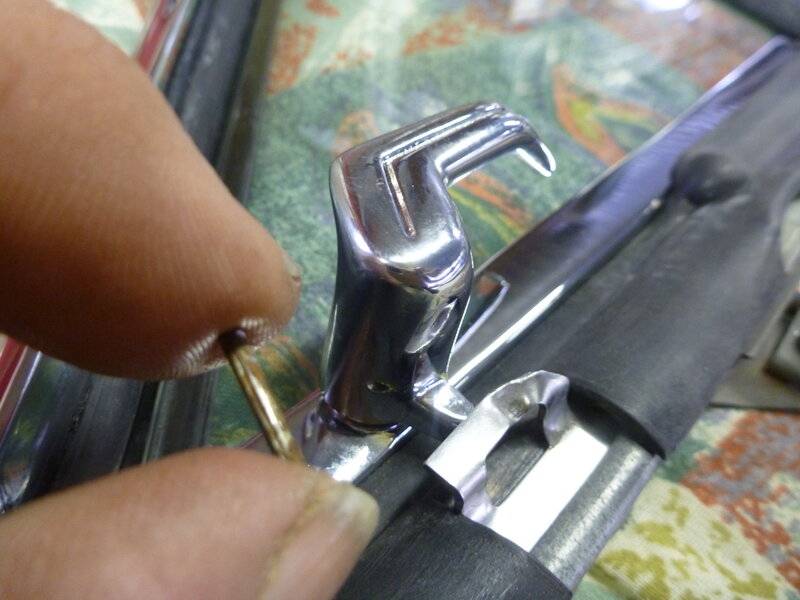

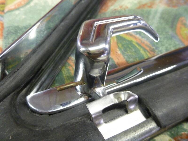

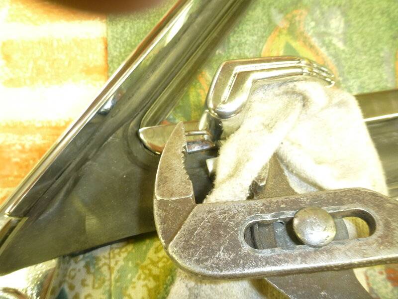

You don’t say what your car is. Looks like a 1969 from you title and photo. All 1966-1970 b-bodies have a small pin to retain the vent handle.
YEP, pin as advised by R413...
ACE Hardware or Homedepot for a split pin that fits the hole... or post a WTB here and someone will help you out with a proper pin!
