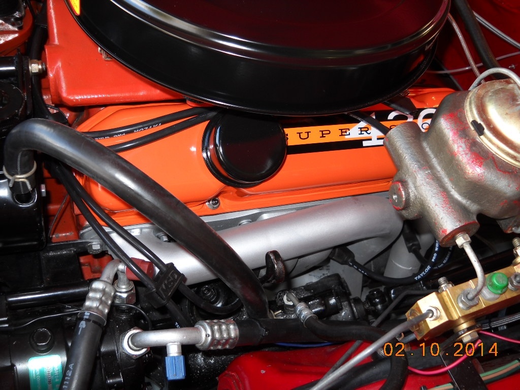

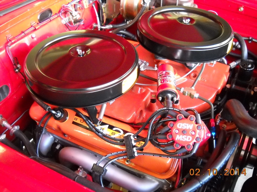

He's referring to the brass or steel fitting that you draw vacuum from in the manifold. Installing it in a plenum area (open to most cylinders) is preferable to installing it in a manifold runner that only feeds one cylinder, but often you have no choice. Not a big problem in my experience. And yes, the actual valve goes in a grommet on one of the valve covers. The opposite valve cover will need to have an 'open' breather to supply make-up air for what the PCV valve is using. Left picture is the PCV valve on passenger side; Right picture is the open breather on the driver's side.
