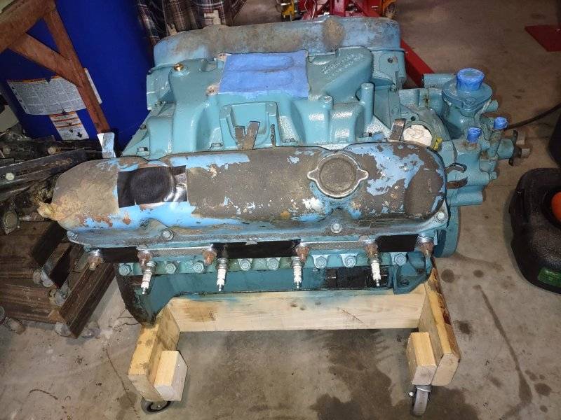

These grungy valve covers came off my 73 400. I believe this is the correct orientation based upon the filler cap being at the front of the engine. That puts the PCV at the driver's side rear. Also note the wire looms which typically run on the passenger side.
That’s what I was thinking too, but I wanted verification.
