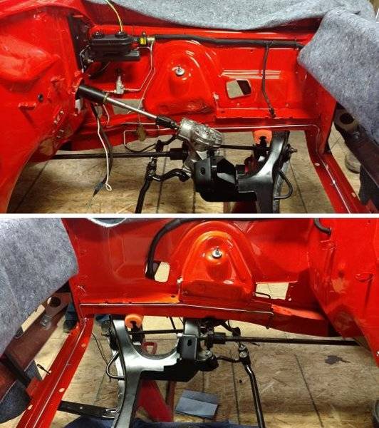

Barb Cooke's 69 RR race car -

Not to get off topic but what purpose /benefit is it to have a manual prop valve feeding into a distribution block (auto prop)????
Thanks
Thanks
Good question Mike. I'm really not sure why. It's just a distribution block so I'm guessing it made the routing to the rear easier or cleaner.
The only reason I can think of not to do it that way is if you have a brake warning light hooked up. The distribution block has a pressure differential switch that would light up, meaning there is a brake problem. Think this is the reason?
She's not utilizing a warning light so I just don't know for sure. I'm going to ask because now I'm curious.
I'm no brake wizard and am still learning my way around the black magic that makes systems work.
Its hard to see the block in the pic but it sure looks like a factory type prop valve...are you sure it's just a distribution block???? Or am I misunderstanding when you say distribution block???
Thanks Shorthorse/Fran!
