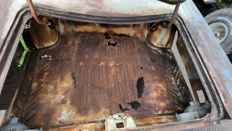

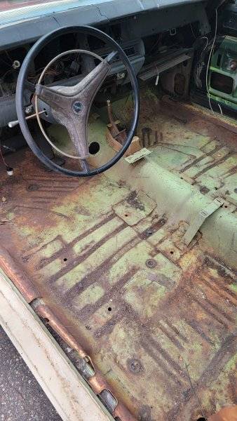

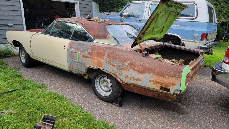

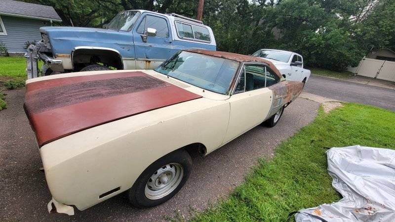

I recently purchased a 1970 GTX. Pretty solid car except the rear quarters and trunk floor. Trying to decide if I want to keep it with ac or delete it and put an air grabber on..

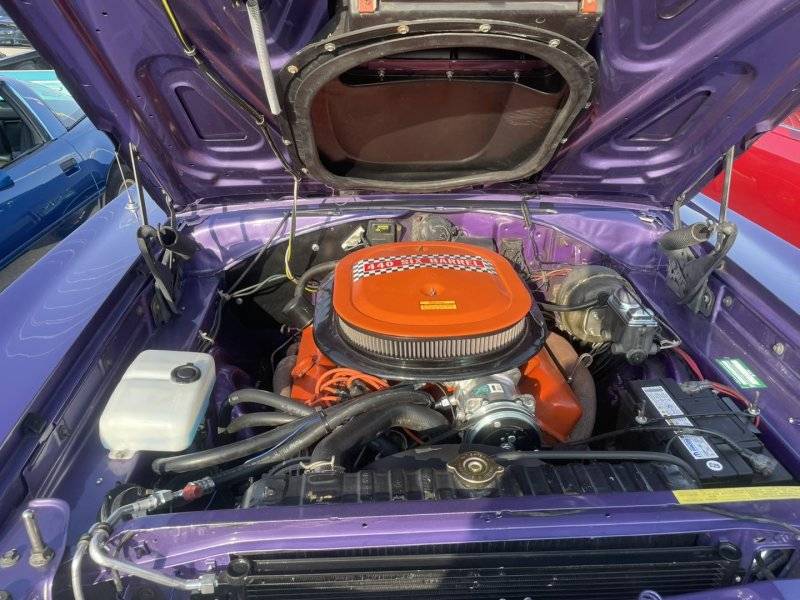

I would love to have both but I've heard that the airgrabber intake and seal under the hood hits the ac equipment so cars with ac didn't come with air grabber hood

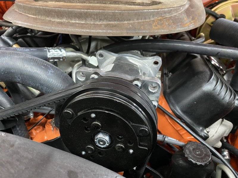

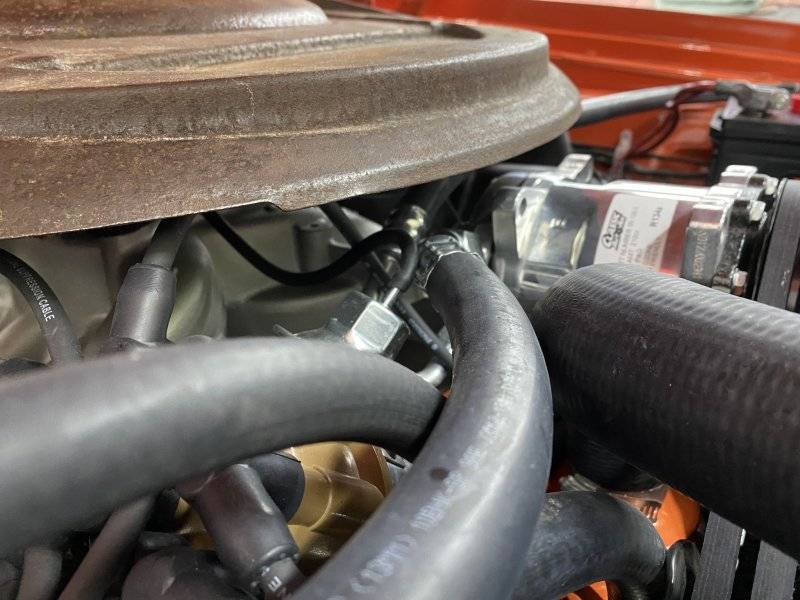

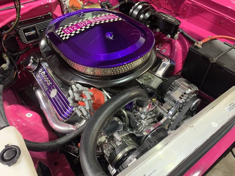

Here is a pic of a 70-72 440 Air Grabber base mounted with a Sanden AC compressor. You can see if the fittings were out the top they would hit, but rotated 90 degrees there is plenty of room. Now this is a Performer RPM intake so if you have a stock intake it will be an inch or so lower but will still clear.
