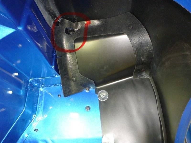

Does anyone have a decent picture of what the top left bolt of the splash shield bolts into? I circled it in red in this pic. My splash shield is missing this and I have a new shield on order. I looked in 70 fsm and no luck. Any help is welcome.

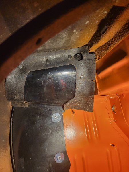

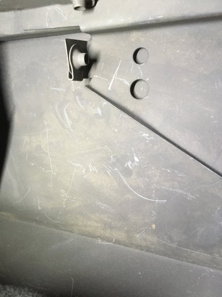

As I just sent you in the PM, pic that took for ever to find. There is a tab off the bottom of the fender top that takes a clip on J nut, then stud and once shield is in place a captive washer nut.

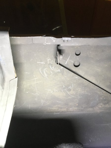

Hopefully someone has a better picture showing the clip nut and stud before the shield is in place.

Thanks again!!!
Maybe it's just a bolt and not a stud / nut. I'll look next time I'm in the shop, day 18 of being sick.
Thanks again! Feel better!
Ok. I got it. Tab is on fender. Thanks again!
