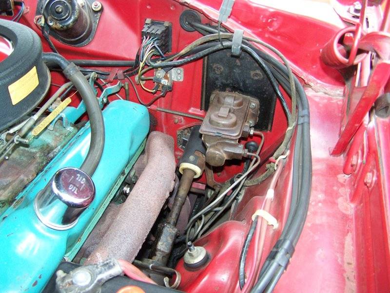

Wanted pictures of an original Mopar master cylinder 1968-69 B Body with 11-inch drum brakes. Bob Horman
Thanks to all who helped with pictures. You guys are great! Bob HormanSo they're the same- sames as the 10" brakes
One cannot assume that master cylinders for different applications are the same even though they look the same. They often have different size bores but share the same casting. In this case, I believe that they are indeed the same and both applications use a 1" bore.Thanks to all who helped with pictures. You guys are great! Bob Horman
