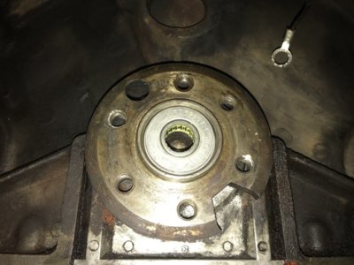

Anyone have a part number for a big block roller pilot bearing? The one that fits an automatic style crankshaft. 1.805 x .754
One from an 80’s Dakota or call Brewers or Passon.
Charger Dana, thanks. It's going in a Scat crankshaft. I was using a TF727, now changing over to a manual.
http://www.brewersperformance.com/proddetail.php?prod=PB5300
This is the "roller" type input shaft bearing that fits in the back of any crank. It's made to fit in the recess in the crank
that's there for "registering" by the torque convertor in an automatic.
Don't go lopping off the end of your transmission input shaft. You won't need to - just tap this bearing in place and you're good to go.
I just put one in my 440 recently. Works like a champ.
FC69907. Just put one in mine.
95 or so Dakota will get you there
I'm having issue with install pilot bearing on my 4 speed crankshaft . New one is very tight I don't want to bang it in! Any suggestions thanks
Put it in the freezer for a few hours, it should shrink enough to go in.
