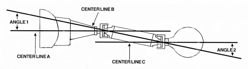

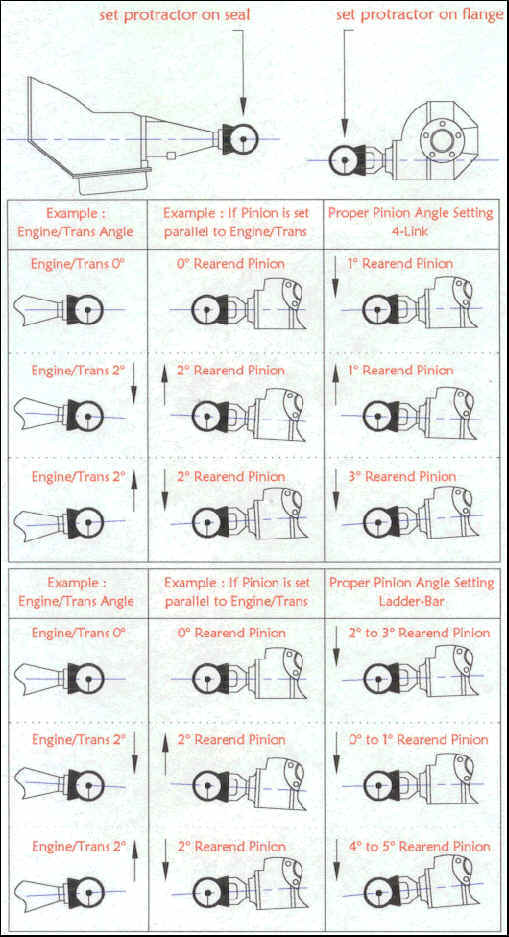

i just went through all of this & this is what i set my angles ,,trans is 1.5 going down from left to right,shaft is .5 going down L to R,
rear end is 0 not under a load, i also had a nice lite 4 in diam alum shaft built.
We're pretty close then, my motor is 2.5" down with the pinion up 1 degree which equals a 1.5 degree difference like you. Did you have a vibration and if so was it only on coast, high rpm's or all the time? Thanks
