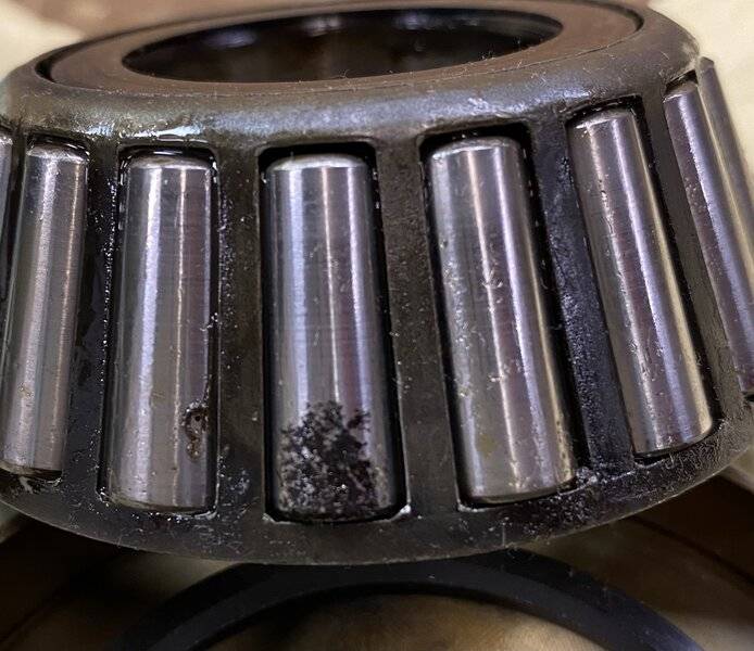

Would you replace this? Pitting is only on that one roller, the rest seem fine.

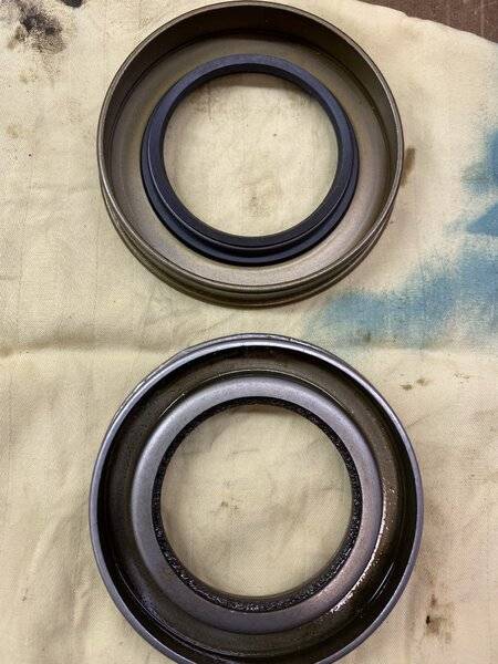

Difference between a new Dr. Diff 742 seal and an old original
Yes, yes you would. Along with the race, if doing properly.
Yes.
That 1 pitted roller won't spin around as freely and will progressively deteriorate.
As fast as that driveshaft rotates, it wouldn't take long until the metal pieces will wreak havoc on the entire bearing.

There should be numbers on the inner race of that bearing pictured.
NAPA (or any decent auto parts supplier) should either carry it, or be able to cross reference it to their number.
Shirley, you must be joking?
that will ruin everything else.
there are numbers on the bearing and race.

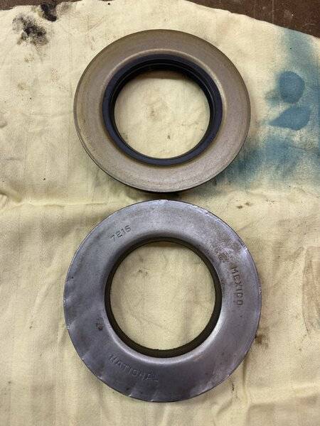

I bought a nation 7216 from rock auto, it looks like the new cheapo seal. And it leaks! I’m not happy. The house and everything was very nice.
The photo on rock auto looks like the original seal, and then they have this cross section drawing which is the new cheap seal.
ABSOLUTELY CHANGE THE BEARING (cone) and the race (cup) and the seal. IMO....use TIMKEN components (first choice) followed by SKF, Bower-BCA now Toyo, possibly RBC (Roller Bearing Corp.) but not NDH Hyatt (Delco New Departure Hyatt) was a GM subsidiary. Inspect the other bearings and races on the same pinion and possibly the carrier bearings as well, for FOD or Foreign Object Damage. Just my opinion of course.
BOB RENTON
If you have it apart, why not replace all bearings? Yes, more money, but peace of mind and you won't be tearing it apart again if done properly the first time. JMO ruffcut
I pretty much figured it needed replacing. Especially since it was already out. I was just going to replace the seal and decided to pull the bearing out. Glad I did now. I’m showing a Timkin M803149/M803110 combo for this, does that sound right?
Got a set of timken bearing and race on order. Already have the seal. This bearing looks to be packed with grease. Wonder if that somehow would hurt it in this type of application?
Dr Diff has the proper seal. Like the one you have from him, it does look different by not having the outside flange like the original. The thing is you'll have a hard time finding one with a double lip. The ones that the parts houses carry will be mostly a single lip or a leather one. Both don't last long at all. The new one you got from Cass is a double lip.
Do they both measure the same? The old one looks larger in the pics.
