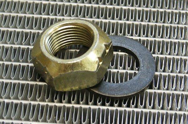

Here is what I am asking the first nut I took off wasn't Crimped the second was . Which is better ?
OK that's what the last one looked like. One of the guys replying said something about a single use nut . Is that pic that i looked at one if those?
See the 2 dimples on the side of nut? that's how they egg shape the nut it acts like to lock the nut.
Correct....It doesn't matter which one is better as long as the nut is good and torqued properly.....Glad your not trying to find the rare dana 60 locking nut this convo would go on forever....
That looks like a 3-hit (3 sides) to me. The nut is distorted to cause an interference fit. Here's another.....
