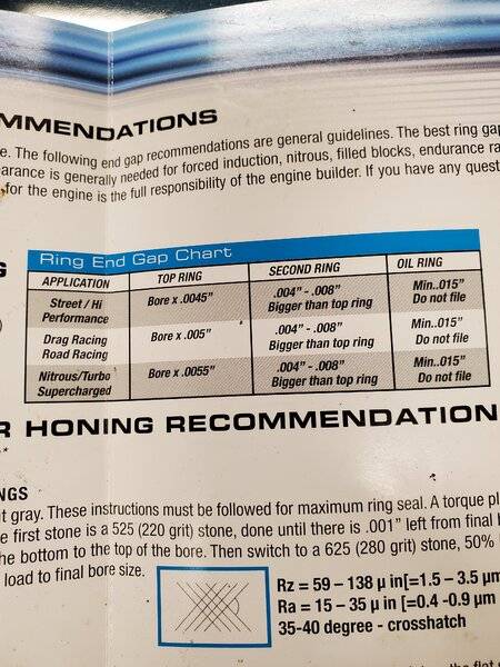

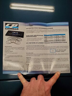

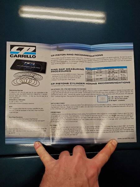

I'm no expert, but here is the chart I followed from Carrillo if it helps.
View attachment 1009436 View attachment 1009437
Thanks for recommending our piston ring end gap chart! I answer these sorts of tech questions all day long at work. I custom cater end gaps for different applications when I have further engine data from the customers. You guys are welcome to hit me on this forum or call/email me at work with piston/piston rings/connecting rod questions.
