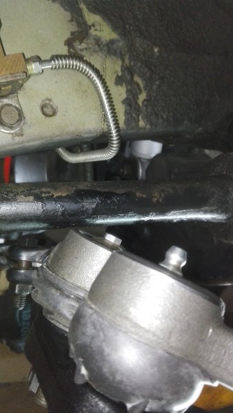

I have just get a new pitman from Rehrenberg, and I think it´s the wrong part. It hasn´t any part number in the box.
I have installed it and the left inner tie rod end scrape a little against the torsion bar when turns to right, car on the floor. On the right torsion barthere is enought roon to a finger.
Some of you knows the measure of the Moog K780 indicated in the picture?
The part I have received measure 4-1/4 inches. I think it would be between 4-1/2 to 4-3/4 inches.
It´s a 66 Charger with power steering.
Thank you.

Yes, I have the original, but I don´t know if it´s the correct one also. It has too play but when installed there is more room to the torsion bar. (1/4 around). The new one seats deeper on the steering gear shaft. 1-1/8 shaft splines diam.
For B bodies I have found Moog p/n K780, K7075 , K7076 and K7102.
Hi guys, somebody could meassure the dimension in my past picture?. All original 66 Charger.
