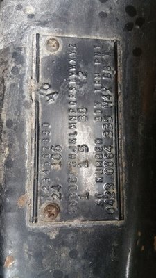

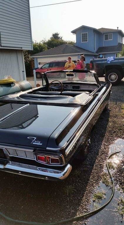

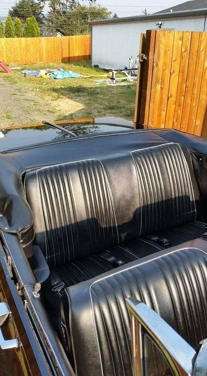

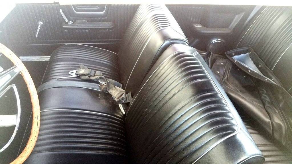

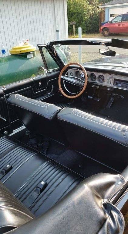

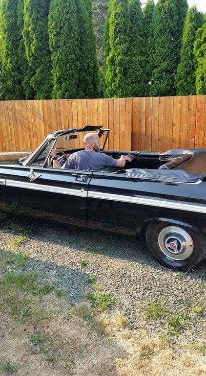

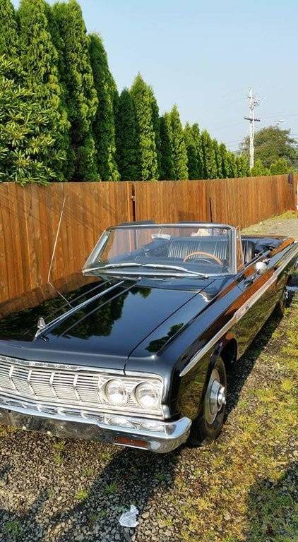

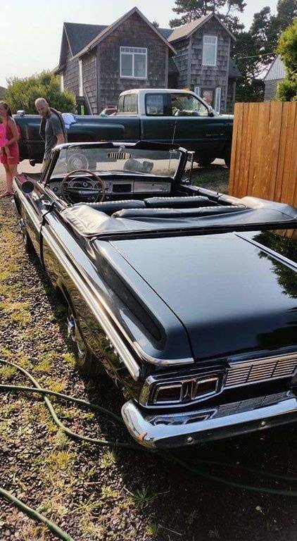

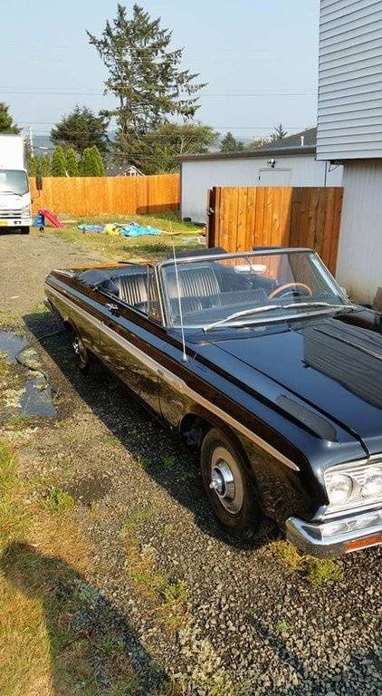

I have a 64 fury convertible I picked up at auction recently. 318 poly with a what I'm told is a factory 3 on the tree. The car was owned by a gentleman up in Washington state that owned around 80 plus cars mainly Mopar. He passed away and his family auctioned off his collection. His son and daughter told me the fury was his baby he had restored part of it over 25 years ago and then put it away in his shop with a car cover over it. His son told me he had not even seen the car in 25 years and was not allowed near it. I was told that it was all original numbers matching but I'm not sure because I have not been able to find any information on the Internet of a 1964 fury convertible with a factory 3 on the tree? This would have had to have been a special order? Or ? Anyway I took a picture of the fender tag in hopes that someone here could help me. I also will include the pictures of the last few days of getting it and then getting her running /cleaned up.

Believe me, if/when this motor goes a big block will be going in. But i would feel wrong about modifying an all original car with a factory 3 on the tree I was told this morning that the (C1) on my fender tag indicates factory 3 on the tree. My odometer reads just over 1,700 miles, I'm assuming 117,000 but I'm still waiting on the title hold. I'm not too worried about the motor the 318 poly still puts out some power and for the time being it's fun driving with the 3 on the tree. (Believe me a 4 speed would be more fun) but again she is inot amazing shape we did all new breaks yesterday, fuel filter,master cylinder, air cleaner, cap,plugs,wires, oil/oil filter/ coolant. I'm putting in a new fuel pump today and going to adjust the points and then all the old bushings/shocks will be done next week. Other than that the car will be great, she said as straight as an arrow. I'll post more pictures later today. If anyone had any other info on the fender tag please let me know. Thanks again guys.

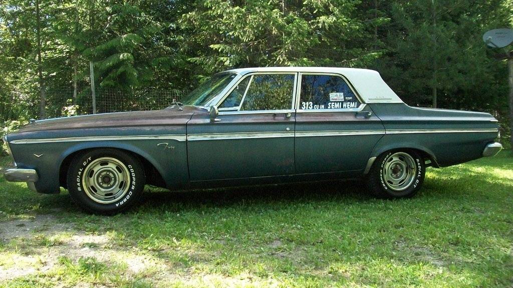

As the saying goes,,,,it's yours and you can do what ever you want to!One of my cars is a 63 fury,with 313,push botton and well worn paint,and people say,,WHEN YOU GOING TO RESTORE IT? I hope ,never,,,will drive and enjoy it the way it is!That way more people can tell me what to do with the car I own.CHEERS

On the fender tag, the engine and transmission options would be shown under the letters A through Z, but they were not always included, but the numbers 015 would denote a column shift car (without power steering), also the paint code on your tag is W, which stands for white color paint.
No code under the AB tells us the car received the standard engine.
The 1 under the C tells us the car codes 341 column three speed.
The paint code is BB indicating a black car. The W refers to the white sweep/side molding.

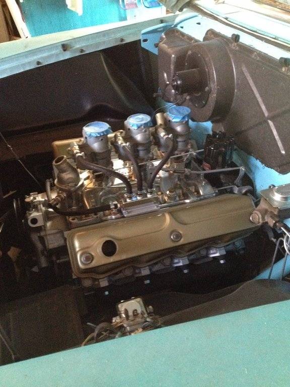

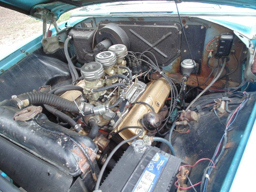

poly's can make some power and have a cool look with twin inline fours . even todays sleeper poly's with a 4'' stroker crank make power at some big block levels . thats a driven torquey motor . if you must change it , just stroke it , your bb buds will be in aw . my buds 277
poly set up with three duces
Yeah like I said before my only plan at this point is one keep it original and just clean it up a bit. If the motor ever blew I would consider a big block . So far we all we have done is, new breaks, master cylinder, oil,oil filter, fuel filter, fuel, cap,plugs,plug wires,fuel pump, and hoses, and a few other things.
kind of looks familiar.. :)
