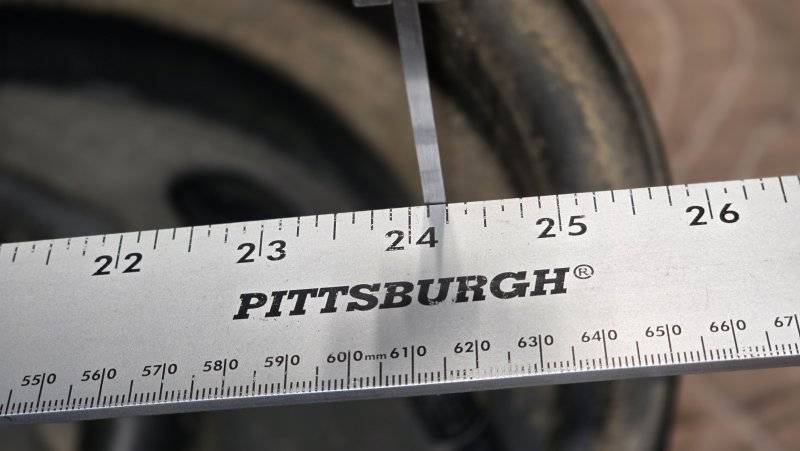

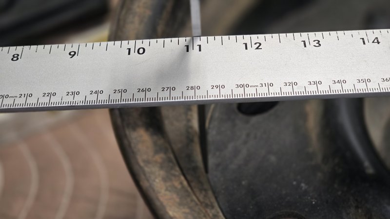

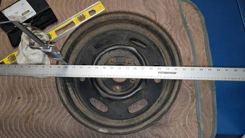

I can post measurements tonight or tomorrow.
The inside diameter of the barrel is 13.25".
(24.25-11.00=13.25)
Measurements taken on outer side of wheel.
15" x 7" Mopar cop car wheel (15x7JJ). I used to own a retired '88 Plymouth Gran Fury Sheriff's Deparment car.
The center piece is welded to the barrel in four locations. Each weld is approximately 3-1/2 inches long.
I cannot obtain a consistent measurement around the wheel lips because of the forming/fabrication of the barrel, but it appears to be 8 gauge.
The thickness of the center piece lip adjacent to the barrel measures 0.21". This measurement is consistent all the around around the barrel.
Note: This is the backside of the wheel.
