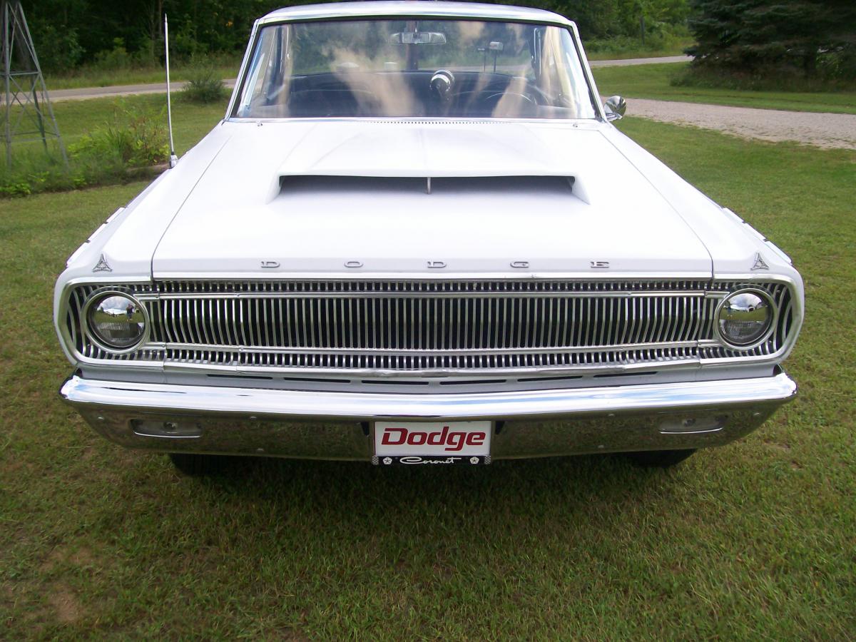

i'm with you on this one i have wet sanded and polished my grille and it looks presentable for a driver sure its got some dings and scrapes here and there its not perfect but i think it gives it some character and patina i would rather put my money somewhere else in the car like the drivetrain i'm after just having a nice street/strip driver that looks bitchin driving around and then you can take to the strip and tear off some high 11 second passes thats what i'm after i think the grille and some other trim pieces needing redone will be way later down the road for me.

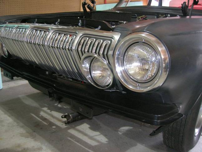

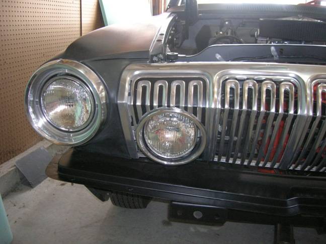

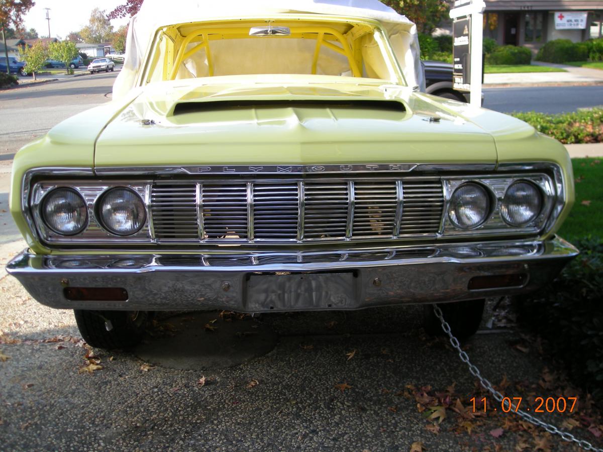

I have been where you are now. My grill needed help. I actually bought a complete 4 door 64 just for the center section of the grill. It's really expensive to make them perfect again. I went a different direction. I found a local plating company in the San Francisco Bay Area that dipped my grill for $10 to remove the anodizing. I hand sanded EVERY pit mark from the surface. It took forever but it was worth the time. Then I bought some polishing compounds from a Good Guys Show in my area. I bought three different compounds that progressively brought out the shine. I did not repaint the black and I think it makes it look unique !!

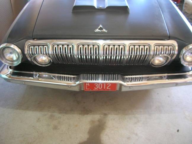

Easy off oven cleaner will take the anodizing off totally. Then start sanding your arms off, then polish. Not alot of money, but a sh!t load of time and most people have more time than money. I converted 2 grilles to make one superstock, and used the easy off oven cleaner then polished, took about 3 months to get it done.

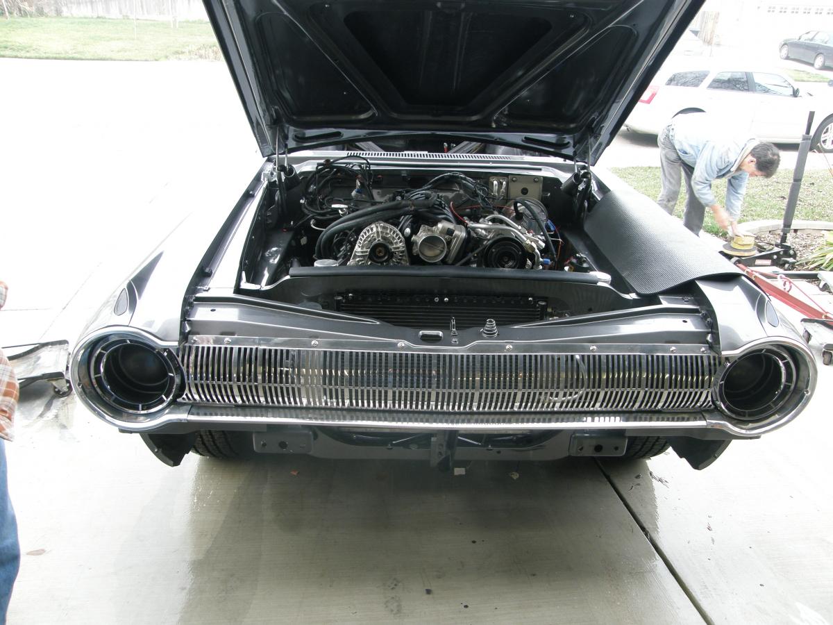

I did the same as some of the others in this thread.
Easy Off oven cleaner and lots of tedious wet hand sanding and then a final polish. I did a lot of it during the Superbowl last year!
Final pic:
I wish I had before pics because it was dented on the top pretty bad, bars were moved, and it had lots of gravel pits in it.
