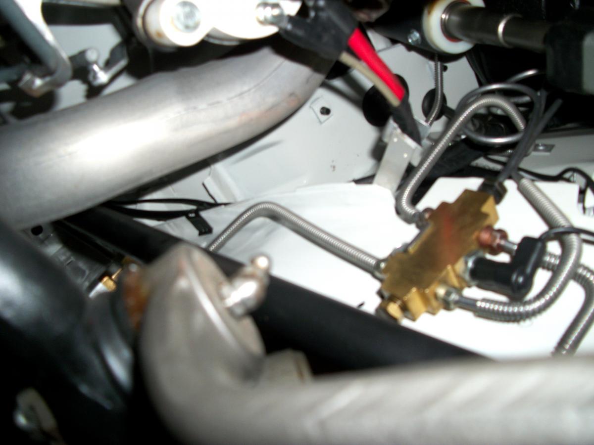

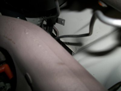

Here are a couple of pics from our 68 Coronet. #1 is looking up from under the car at the larger part of the pracket. #2 is looking down at the smaller bracket. Hope this helps.

Perfect, that's exactly what I needed, guys. Thanks!
