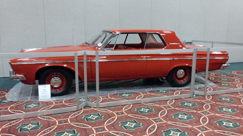

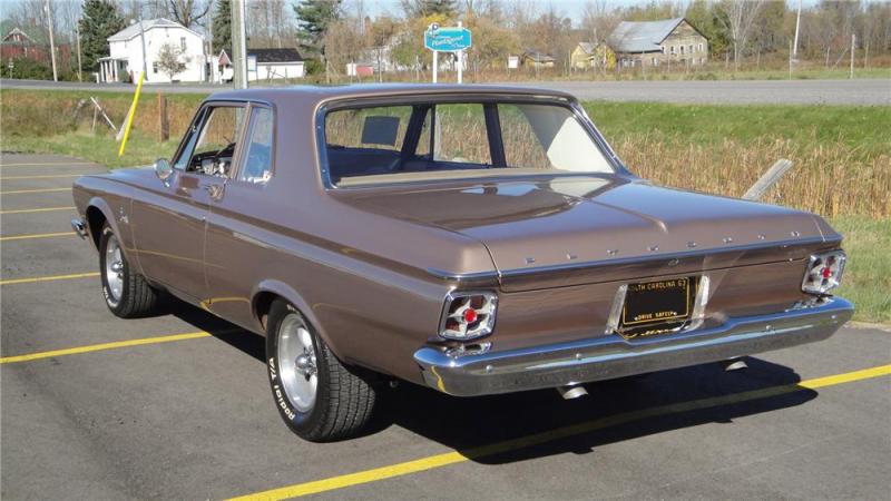

here ya go! top one is a post......second one is hardtop, the dummy did not roll the rear window down!.....:iamwithstupid: maybe he wanted to show all the glass was good & original?

Well that was quite an education, Thanks! Sounds like not a black and white situation like an early RR with a post and a roll down rear window. Sounds like many things they did they could mix and match as they please.
